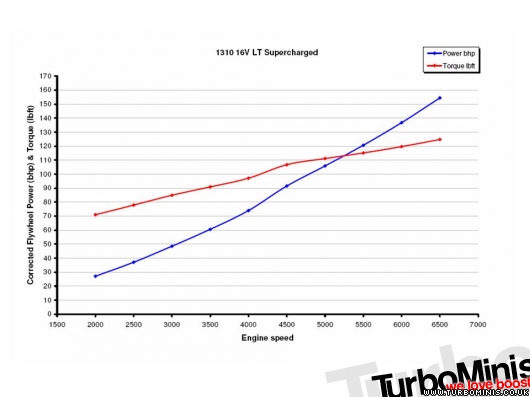

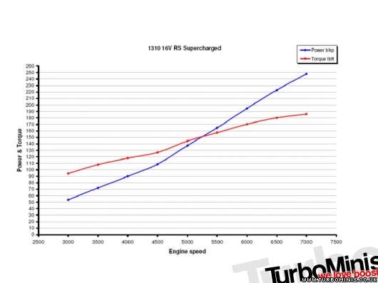

The last couple of engines I've built over the last few weeks have been pressure fed - thought you guys may be interested in the dyno's. Both engines are 1312's the non intercooled version is running lots of stock parts, stock head, LT 254° cams,road exh manifold, 10.2:1 comp, max boost was 4.5 psi at 6.5k. The sportier one is running RS 284° cams, 10:1 comp, ported head, race exh manifold 14psi at 7k, this one is running 6 inch rods and custom forged pistons as well. The conversion kit and charger is the same for both, pulley size altered to achieve boost/power targets.

nice figures
Done now needs redoing lol
Blimey not a bad result at all!
Im guessing these are on your supercharger setups?

The LT cammed motor,
Cast omega pistons-custom bowl
STD bore centres
Wedged/bladed crank/centre strap
A+ rods, resized with arp fasteners
U/l flywheel
Titan billet oil pump
Mahle competition bearings
Wet deck conversion
High tensile studs
3.5cc bi metal gasket
MS clubman gear set
4pin diff
SC supercharger conversion
Billet shaftless throttles
Billet plenum chamber
Charger specific conversion plates
SC Typhoon ecu/wiring
Etc
RS cammed motor
Forged SC spec pistons 2.418 comp height
Steel crank/4bolt main
Sc 6" rods
SC billet oil pump
RS head, mild porting
Mahle race bearings
U/l flywheel
Dry deck conversion
Arp head studs
Quaife diff
Dog box
Typhoon ecu on mpi plug in loom
Conversion kit as above
Race exh manifold
Etc
