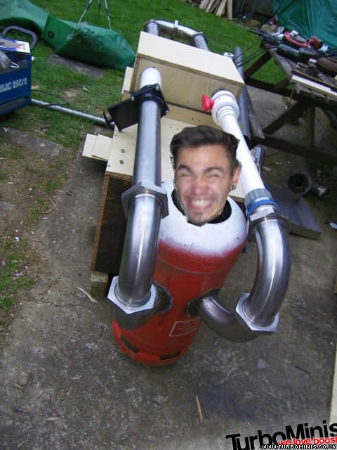

i decided to formalise my bench parts into a proper piece of kit ... ish .
using a 4 hp motor ,a centrifugal fan , and a bit of electronics .
started here ..
Edited by robert on 9th Mar, 2012.
built the box a bit more
and then the diverter valve etc
boxed it all in ,and got some valvey things and stainless pipe n bends ..
made a nice smooth flange from a old manky rusty one (cue ap) then started on the pipework ,or ''trombone''
did loads more work , and this is where its at now .
next thing is to take it all apart ,brace the joints ,and paint it ,and stick some wheels on and wire it up .hope you like it.
regards

thanks paul ,
its pretty basic really , two different sized pitot tube sensor assenblies ,and a plenulung,and a flow diverting valve so i can test in and ex without removing the head .
thanks to neil for all the kitchen cabinet material .
