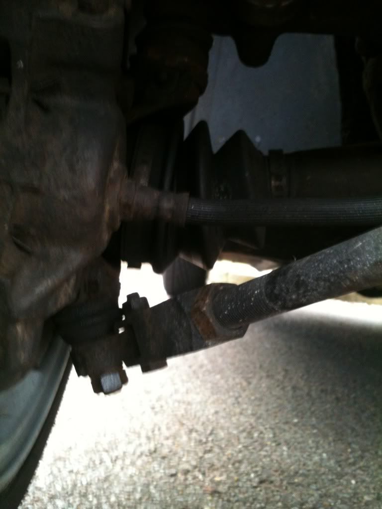

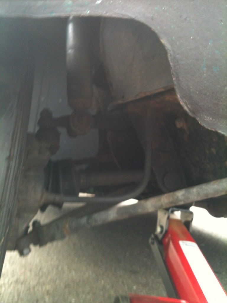

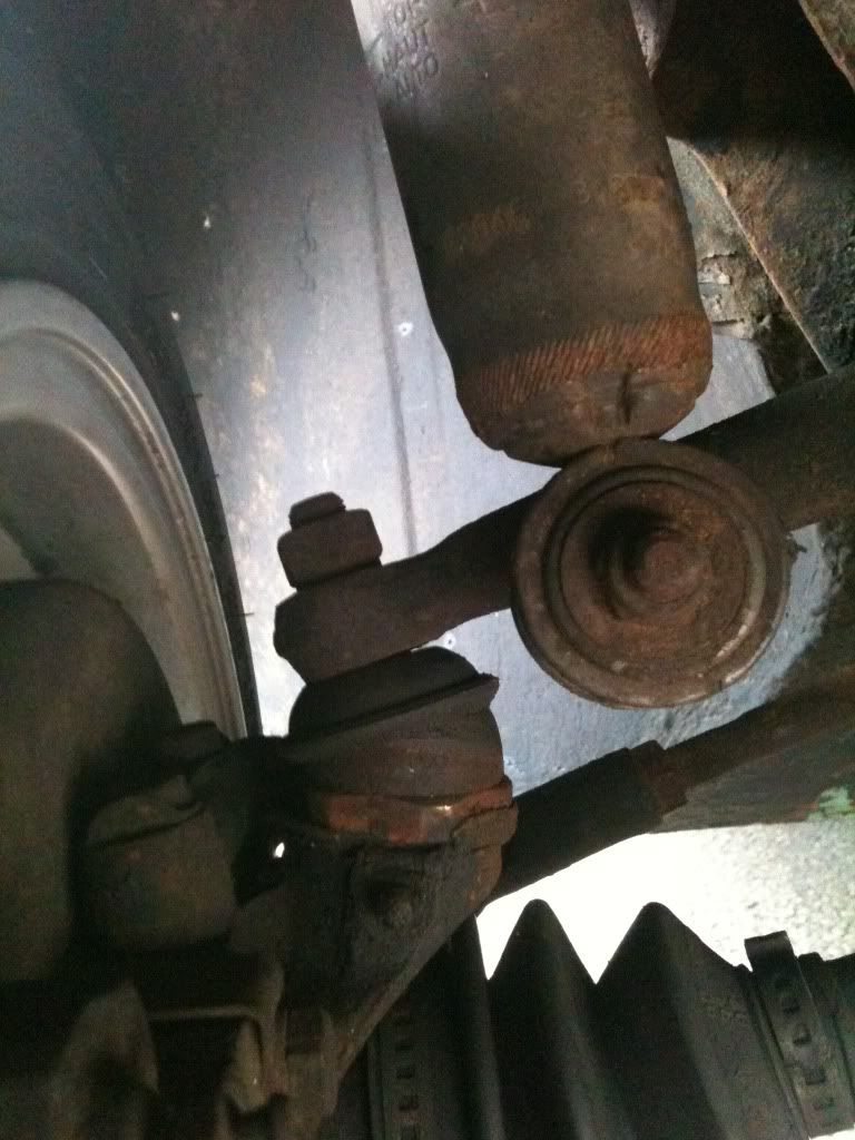

Just had a look under the car, there didn't seem to be any play in anything there, it didn't look like it had been changed recently, but it also didn't look like it was about to fall apart.
I gave everything a wiggle with the car on wheels and with the wheel off the ground, and nothing moved.
I took Carl's measurements, its was about 47in at the front and roughly 46.5in at the back, i couldn't take the measurements at 3 and 9 because of the gearbox and the subframe, so they were dont at about half 4 and 7. The odd thing is, once i'd had each wheel off the ground to have a look the measurements changed, and it was 45 at the front, and still 46.5 at the back.

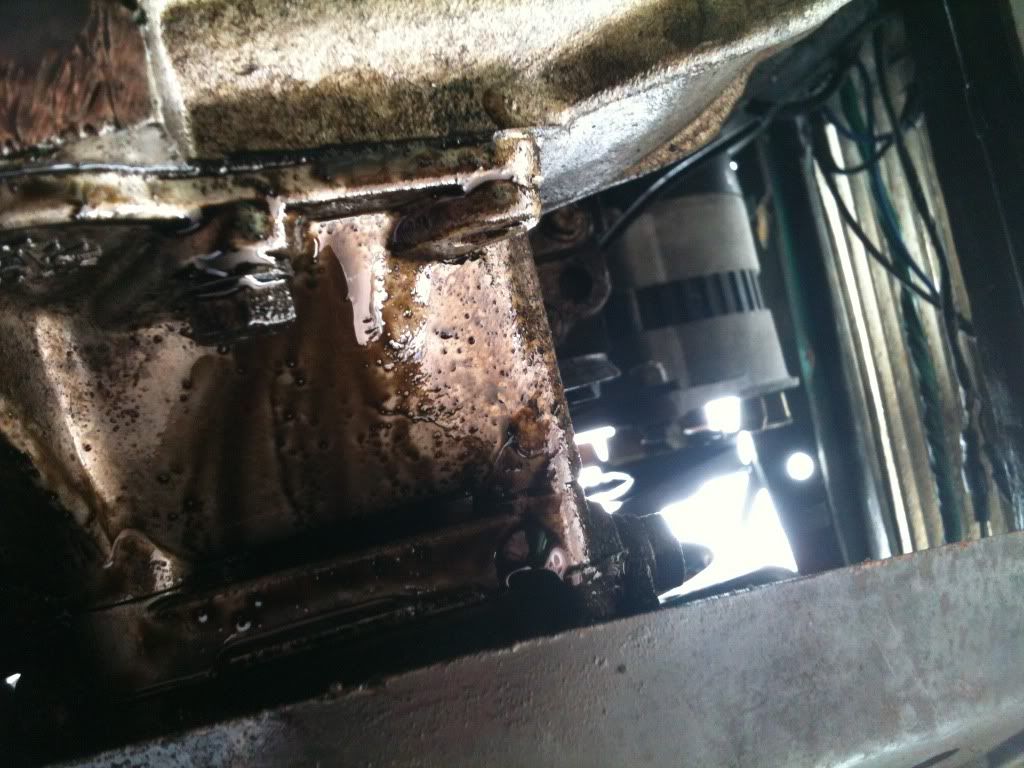

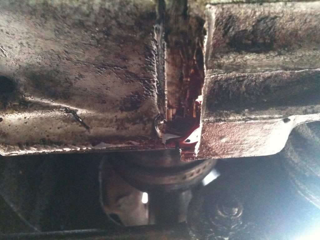

I've also manage to find a pretty serious oil leak, which is hopefully the cause of my low oil pressure, just need to work out where it's coming from now.
I took some pictures, just incase I'd missed something.
This was what looked like a split pin on the bottom of the flywheel housing, was really loose, and i have no idea whether it's supposed to be there:
These are a couple of the oil leaks:
Taken under the gear linkage on the back of the 'box:
Taken under the bit that the rad braket bolts to:
Edited by Mike-998 on 12th Mar, 2012.
Uh oh. Looks like a weepy crank oil seal.
On 12th Mar, 2012 Mike-998 said:
I've also manage to find a pretty serious oil leak, which is hopefully the cause of my low oil pressure]
Nope sorry. Oil pressure being low is down to worn pump/crank bearings.
