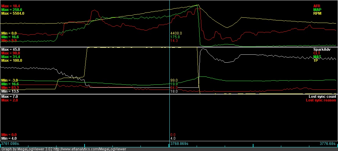

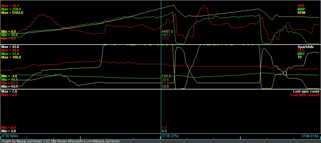

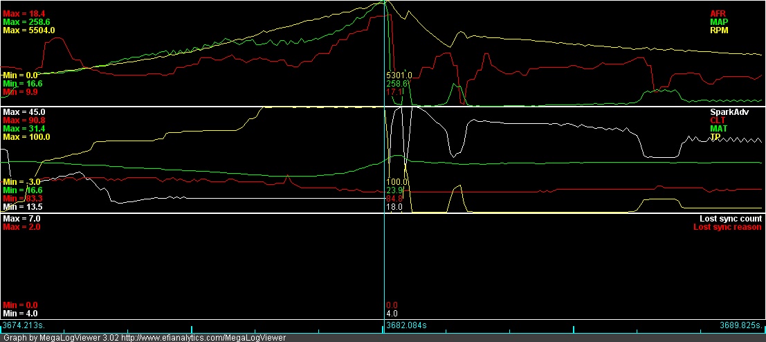

what do you guys make of this, engine runs beautifully but every now and again there is a misfire that is caused by ms loosing sync, never really managed to get decent logs of it but yesterday i got about 3 hours play time and have found these
i have tryed alot of things, but interestingly the rpm are very very close making me think it is possibly a vibration problem or some electrical noise

Reason 2 (as shown on your log) is usually a missing tooth error.
The other logs would seem to confirm it.
Many possibilities.
Vibration (moving gap) of the sensor quite possible.
Noise (at higher RPMs) also quite possible.
What about the VR pot positions - the standard VR input circuit really is crap - maybe just a small tweek of the pots, especially the lower one, would help clear it.
The VR voltage rises with RPM so maybe your gap is actually too small.
Also, double check the polarity of the VR sensor and your ignition input (rising/falling) setting.
Best I can think of at the moment.

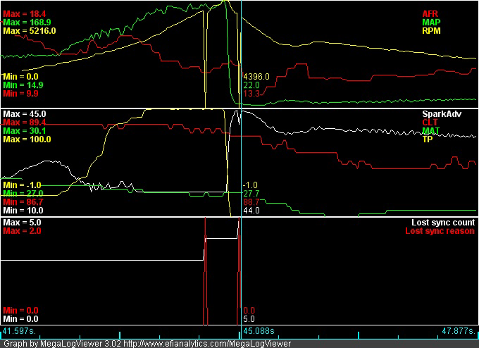

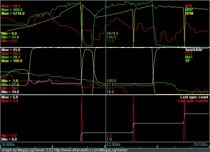

the 2nd Screenshot shows it go very lean, it looks like ages have past by the logs but i lifted as soon as i saw it, or benny called it whichever lol
not bad on a needle i polished up last night with no testing *tongue* i think i need to retry the 12lb spring though the needle seems to be at the top before it finishes revving

investigated and it did although not as bad as i thought, down pipe has been modified now and it made no difference, well it did the boost stayed down longer but just spiked up even faster when it does it, spark cut is now enabled to protect against over boosting
and the misfire at 4.5k is back so i spaced the sensor out another washer(~.5mm) more and it wouldnt start, i have adjusted the trim pots r52/r56
i can get a beautiful start but the misfire when running or pig to start and no misfire cant get that sweet spot in the middle
i cant get a log of the vr signal when its running,anyone know how/ if you can
