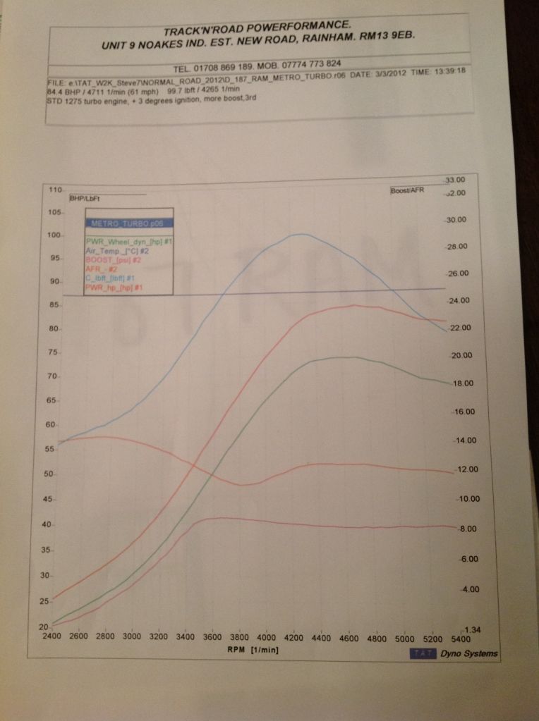

what were the afr and the advance at max torque and max bhp as setup on the dyno tony ?
Tonywells
40 Posts
Member #: 343
Here is the rolling road print out.
Not sure about advance but it's a standard dizzy.
imo thats a low power for 8psi boost
