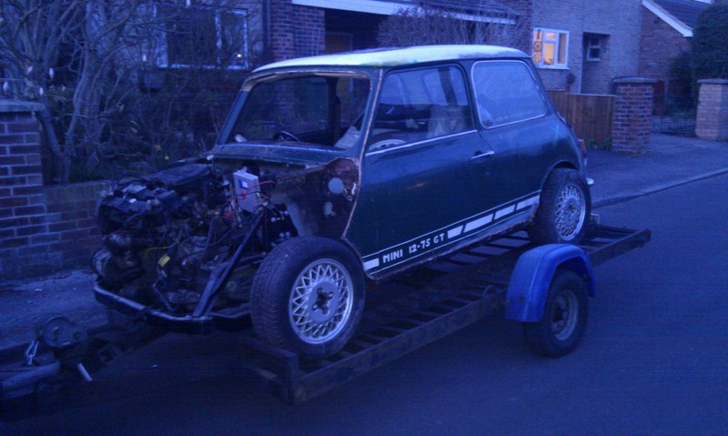

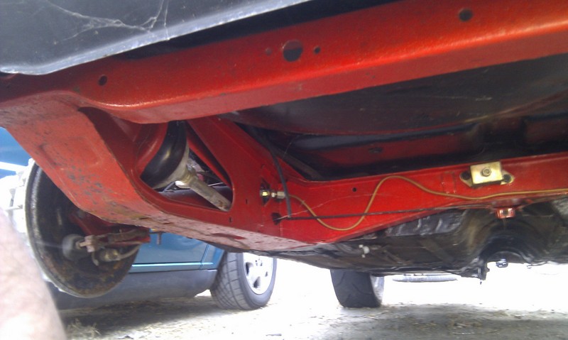

Picked it up on the weekend, will be stripping it this week and seeing whats what. Basically it will need a lot of welding, but all the bits are there and my mate Cheeky Scott (who sprayed my metro) is mini mad and will do the body work / spraying here in Bournemouth
Its not an original colour its like a duck pond green, we are thinking it was originally denim blue but we will see.
Has a metro loom for the engine and a metro fuse box and interior loom with metro clocks

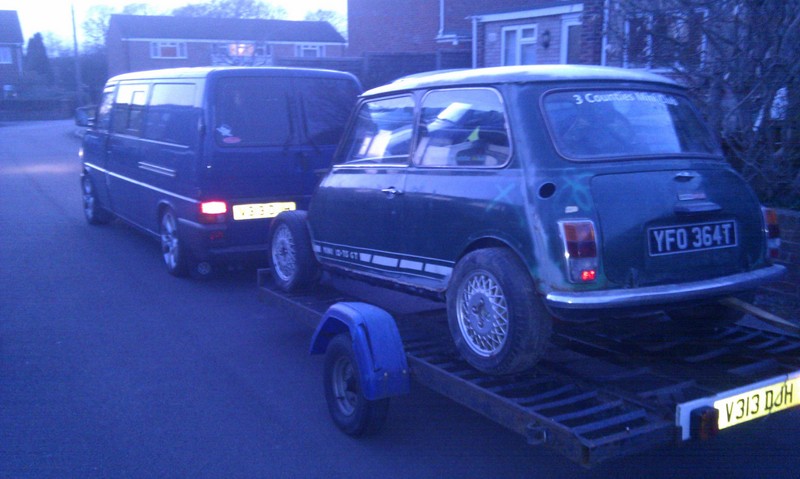

Looks like this on the back of a truck
There is also talk of junking the 160vvc (which has a MEMS2 loom, inlet and manifold due to me having this left over from my metro vvc), we have a Rover 100 Ascot that could take this, and putting a 1.8 turbo in with an emerald and shooting for 220bhp but will need a PG1 and quaife diff for that

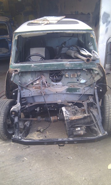

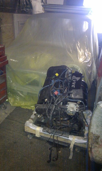

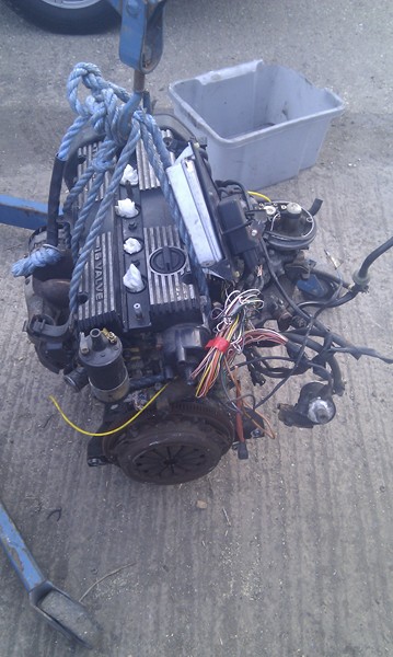

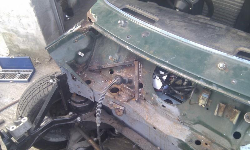

Took the engine out today and cleaned the engine bay out
R65U wants to be changed to a PG1 with torsen, but as yet havent found one. Should have the front back to metal soon clean up the crap welding and get it sprayed so i can fit the engine
Need to change the SPI tank fuel pump to the VVC one i took out the tro, feed some pipes front to back and hook up the front brakes before the engine fitting

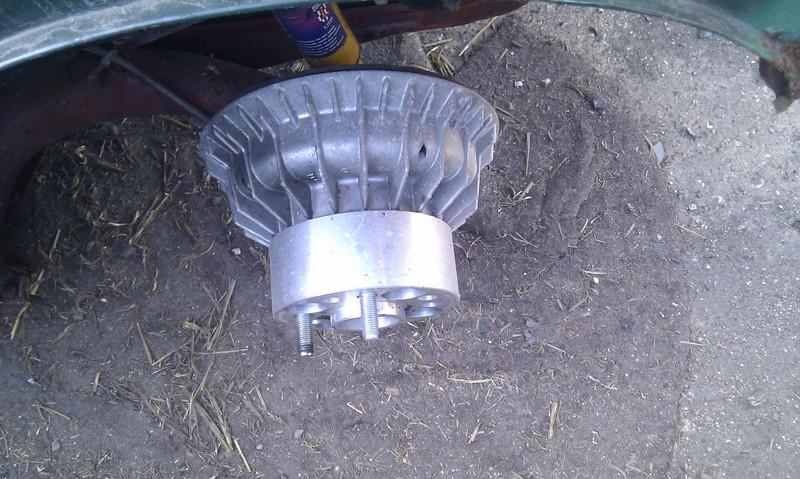

Going to take the 185 55 13 Toyo road pros off the GTA wheels and fit them to my MPI's for the metro
Need ideas on what wheels to fit so it doesnt look like a mini on metro wheels. Will run 175 50 13's too

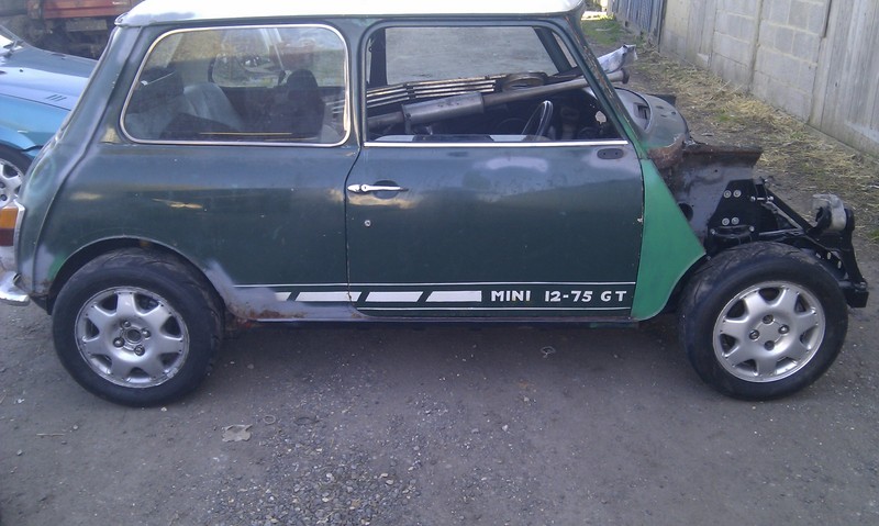

Few things changed, i bought a PG1 with a torsen diff so going to change out the R65U as the car will be tracked and looking at 1/4 mile times the diff cars are 0.5 quicker in the late 13s
Also removed the cross spoke alloys and stole the near new Toyo Roadpro 185 55 13s and put them on the metro
So had to fit my Avon ZZRs which look ok, my mate says it looks like a mini on a metro chassis but will collect steelies from Tony Itsonlyme on thursday, along with MGF Calipers, carriers, 160 6 bolt manifold and MGF shafts for the PG1. I have some spare discs and pads (chocolate green stuff) for the time being

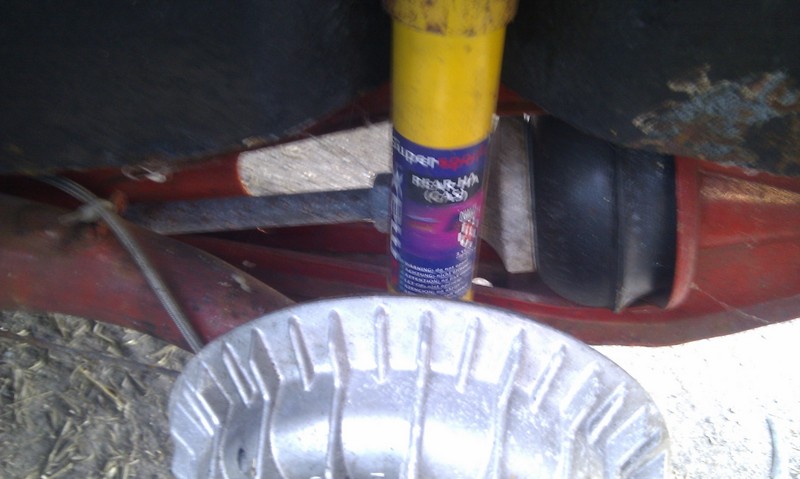

Spacers on the back look er fooking big
Subframe is new with braided lines for the brakes with spax shocks *wink*
