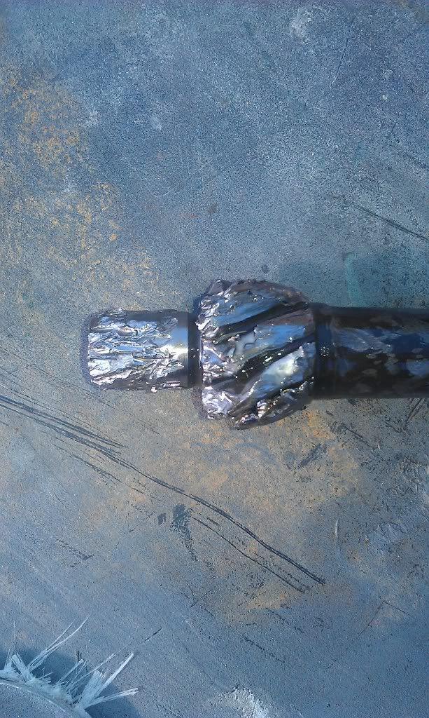

And the drive was complete? Not teeth missing?
I did the very same thing in my 998 - the drive got chewed a little and a few teeth ended up in the oil/gearbox.

The teeth were a bit mashed, but no huge chunks or anything.
Got Pics?

Here's mine from a while back...

Good job bennyy!!! Mine wasn't that bad but left bits in the bottom of the box - I used a magnet to fish out most throug the oil sump plug hole!!
