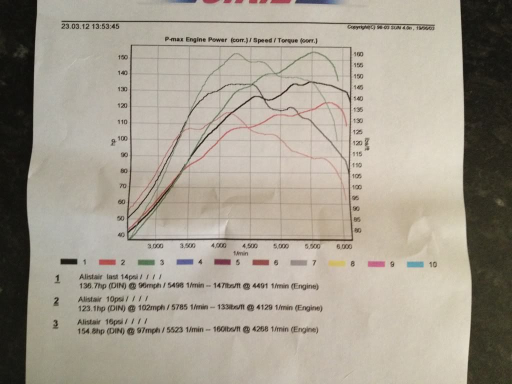

I had the rolling road with SRE today, a good day and sOme nice results.
16psi showing 155bhp, but it wouldn't go over 18psi and at that pressure it was unstable. It got around 163bhp at that but we didn't feel it was good to leave it like it.
There is a bit of oil in the hose before the intercooler but it's not smoking like its burning oil. Could the turbo need a rebuild?

looking at the curve i would say it is not a flow problem
If it was youd have a flat line power curve
