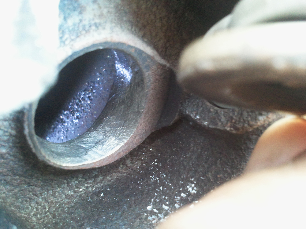

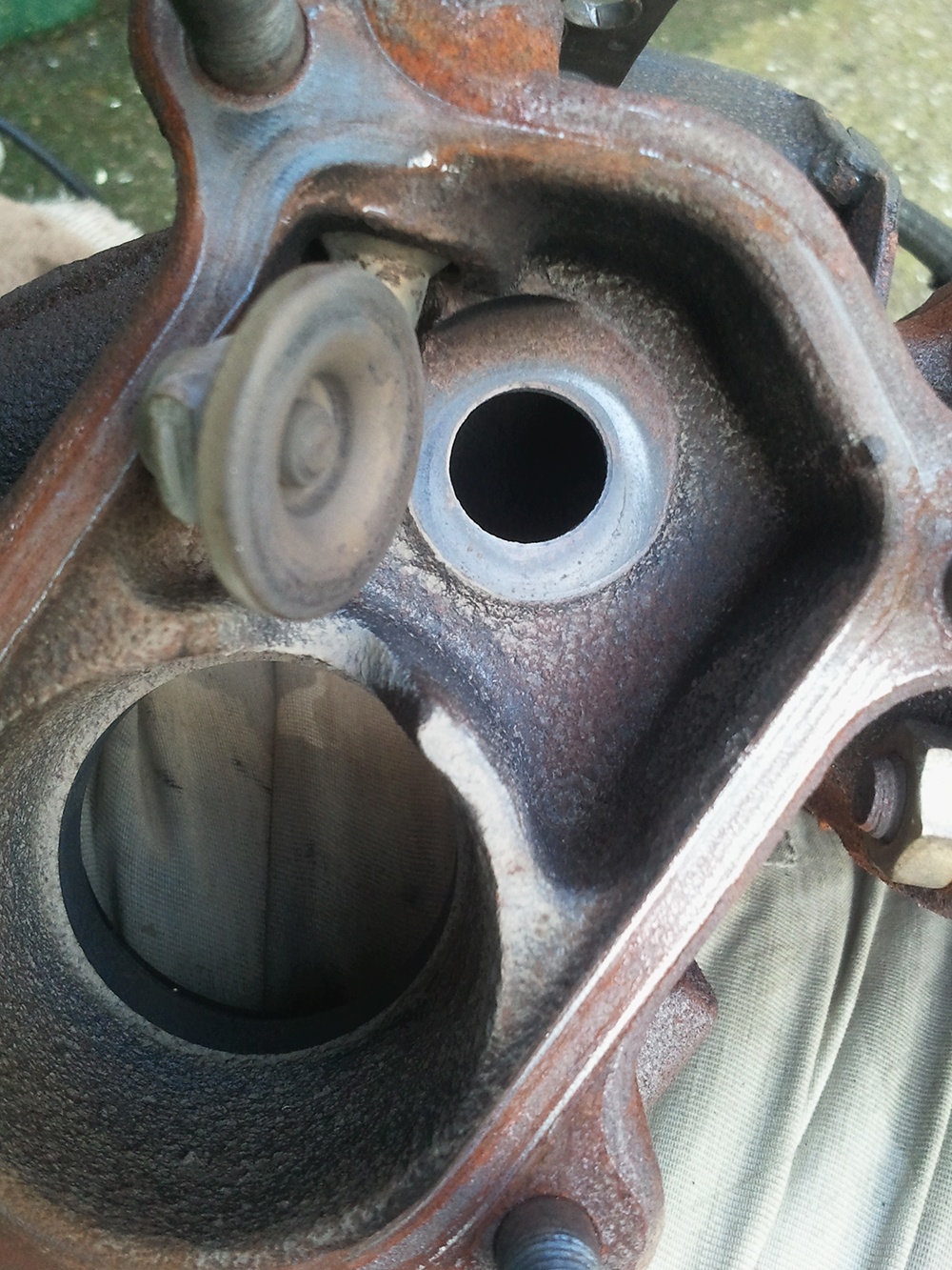

its been on the list of jobs to do since this thread but today i have pulled the turbo and ported out the wastegate port, now some where i mistakenly said the wg valve flapper was only 20mm when it is actually 23.79mm (ish *wink* )
in my spare housing the flapper is central on the port but in the housing on my turbo it was not so i couldnt go as big as i planned but i think an oval 20.5 x 21.5mm should do the trick *happy*
by my calcs thats 53% bigger *happy*
from this
to this
i have no idea how to work out how much that will help by but i have been told the gt17 has a 24mm wg port and can hold as little as 7psi (maybe less) so hopefully mine can hold 7psi untill 7krpm or at least control the 18-20 psi i would like it to hold in anger
Edited by Brett on 22nd Apr, 2012.

well it works *happy* an indicated 4psi on the gauge untill ~6k it felt very slow though i soon reached for the bleed valve hahaha

i replyed on the other thread too, yes completely solved
ran as little as 4psi but swapped to a 18psi actuator, regularly runs over 20psi and 28 with water and alcohol
