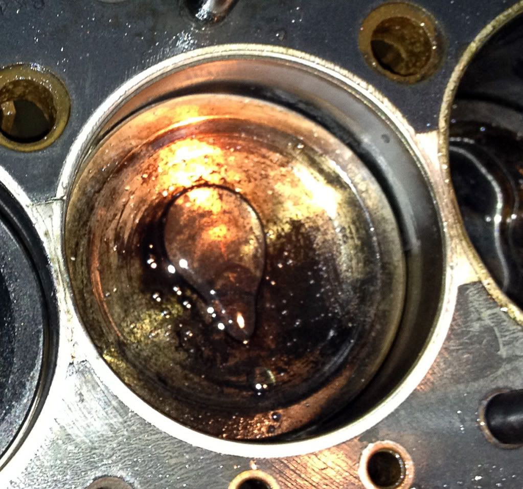

A usual life got in the way a bit and only today have I managed to pop the head of and have a peak inside. At this point its dark and chucking it down but at first glance it looks like piston no.2 as 'shrunk' in the 2 o'clock region. Maybe I'm talking out of my arse but thats what is looks like, I'll try and get some better photos in the morning with daylight and a decent camera.

That's detonation, it's melted the edge of the piston.
As above ^^^^ engine out time. *oh well*
oh, and it is funny how it's #2 and on the exhaust side nearest the front of the engine, same as that one I made^^

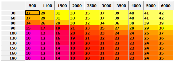

Yes I have a UEGO but couldn't tell you what it was reading when it went bang. It had been running a little leaner than I would like prior to that though and was top of my list to richen it up a bit on the next visit to the rollers (which was the day the wheel fell off on the way to the rollers!)
I'll have to double check my MJ map in the morning for timing figures.
http://turbominis.co.uk/forums/index.php?p=vt&tid=170151

just found a copy of my map on the latop actually. 95% sure this is whats currently saved on the MJ but will double check tomorrow.

that map on that cr should just about survive , have you put a timing light on it to see if its really the right numbers ? what turbo ?
4309 Posts
Pull the piston out to try to identify what they are, someone might have one lying round on the shelf. Though the others might have sustained damage too.
Isn't 180kpa around 11-12psi?
I'd change the buckets in your map to cater for more boost.
At the moment, if you stick any more than 11-12psi through it, you'd still be running 25deg adv. Even at 20+ psi.

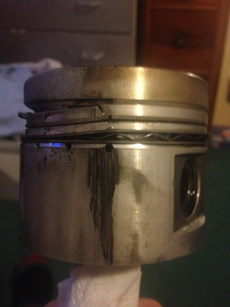

think i found the problem with piston no.2
4309 Posts
I'd happily re-use that!
