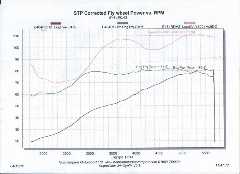

Yep, fuelling from the carbs is way out, we tried all the bits we could but we need a dynojet kit so we can start adjusting. Disappointingly only made 80bhp because it's running very lean at the top end. So lean I'm taking the carbs off and putting the su back on until the fuelling can be sorted out. Need the car for a holiday in 2 weeks and I cant get back on the rollers for weeks. Back to the good old SU. Got to graft a TPS on to it so it will work with the MJ
