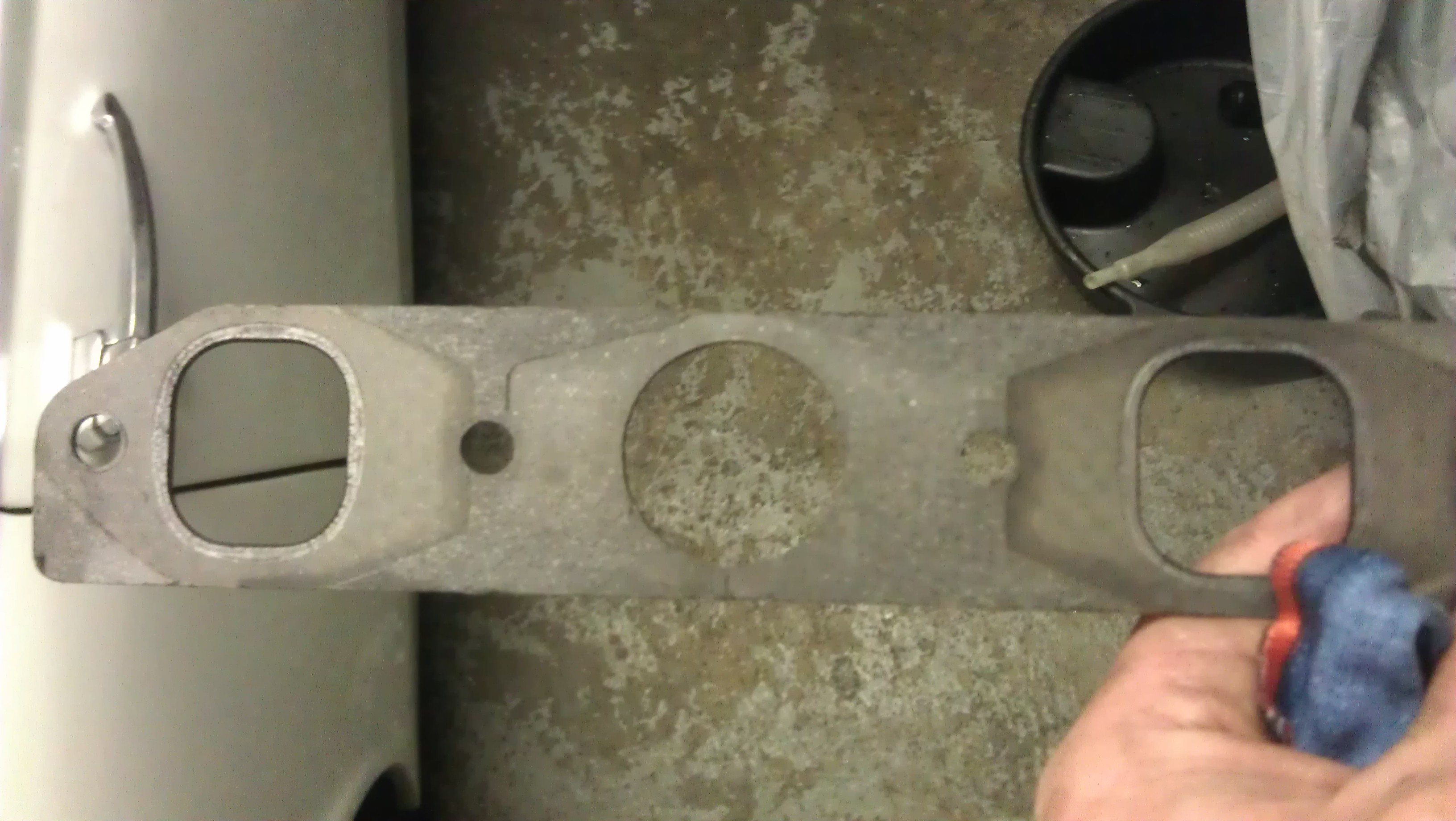

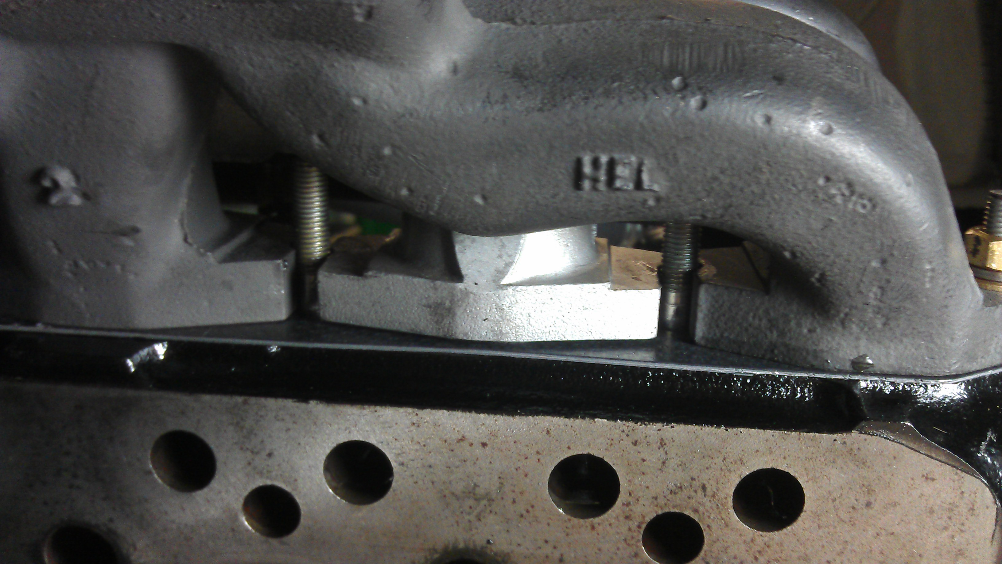

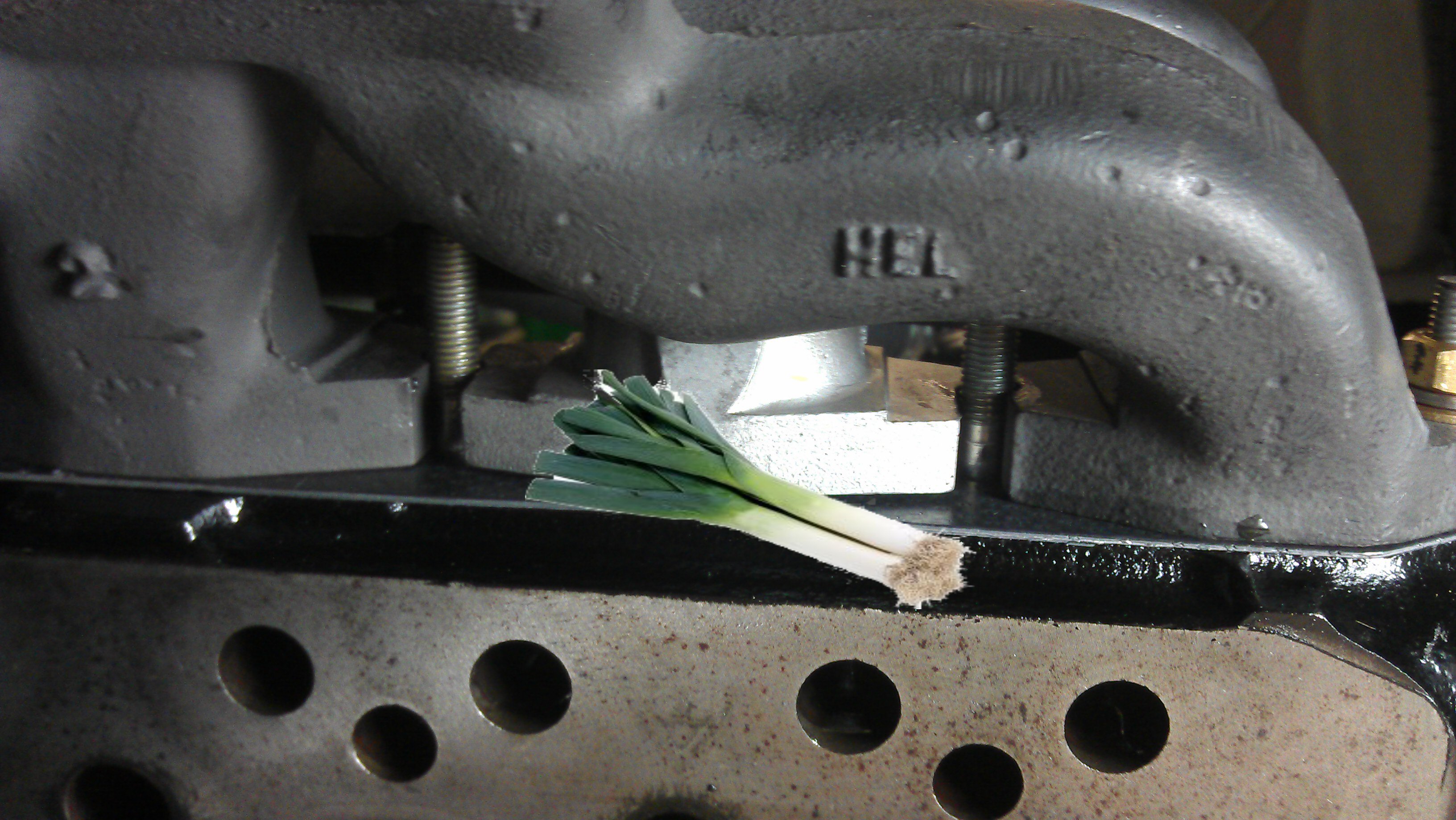

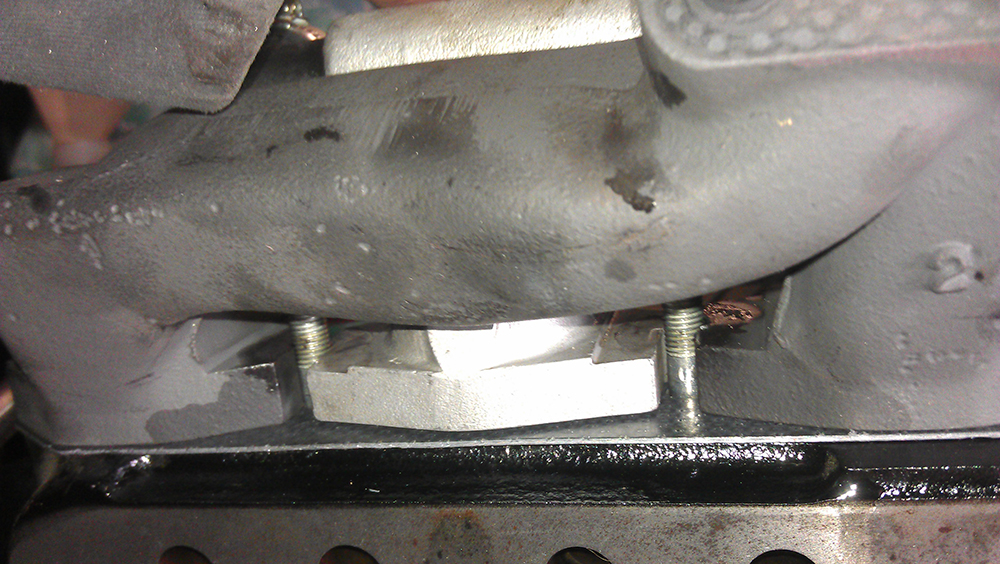

Ok did comp check, 190psi across all 4 cylinders give or take a couple of psi.
MASSIVE manifold gasket leak! Doh!
As Wil suggested inlet manifold hitting exhaust, so out with the Di-grinder.
that is quite some leak.. good skills *happy*
