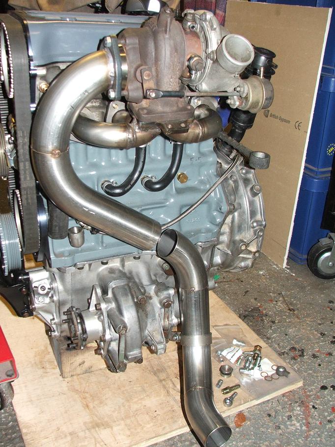

I am in the process of doing my downpipe this weekend, and I'm unsure of the best way of going about it, it will be in 2.25", I'm doing it in 2 parts, doing the downpipe while my engine is out, fitting it all up then doing the rest of the system.
I was going to use a tight 90 bend then a sleeve connector straight after, but I always hated the t3 connector there, it was tight and a pain in the arse, so I thought about welding the whole thing from exhaust flange, down and under the subframe, but that would mean guessing the height at where it bends under the subframe, I hope you are following?
So for those that have experience in doing it, what's the best way of doing it?
EDIT: just realised I've still got my t3 downpipe, so if I bolted that onto the bracket on the gearbox I know the height at which it needs to bend under the subframe, I think that's the best way to go.

All the ones I have made use a slip joint just below the subframe lip. I clamp the joint using a 'Mikalore' (sp?) clamp (they don't deform the tube which means it's easy to take apart and re-assemble). they use a 10mm head to tighten, and I use a 3/8 ratchet, which worlks well.
The advantage, as far as I see it, with how I have done it is you can eaisly knock off the down pipe from the elbow and remove the turbo. a long pipe would make removal and fitting more difficult.
We made a single pipe on the van. If you unbolted it from the turbo and the middle section it would just about wiggle out of the engine bay or drop out of the way for fixing oil leaks...

Same as we did on the van and it was fine. In effect we had a tight 180 of the turbo, then a 45 degree to put it down above the driveshaft, a 90 to get under the car and then the flexi.
I built mine in one peice at first and at the first oportunity i had made it 2peice purely for ease of removal but it helps me tuck the exhaust up tighter in the tunnel mine clamps just after the tight spot between the subframe and the pot joint, it has to be unbolted from underneth but can be done with the car on the ground

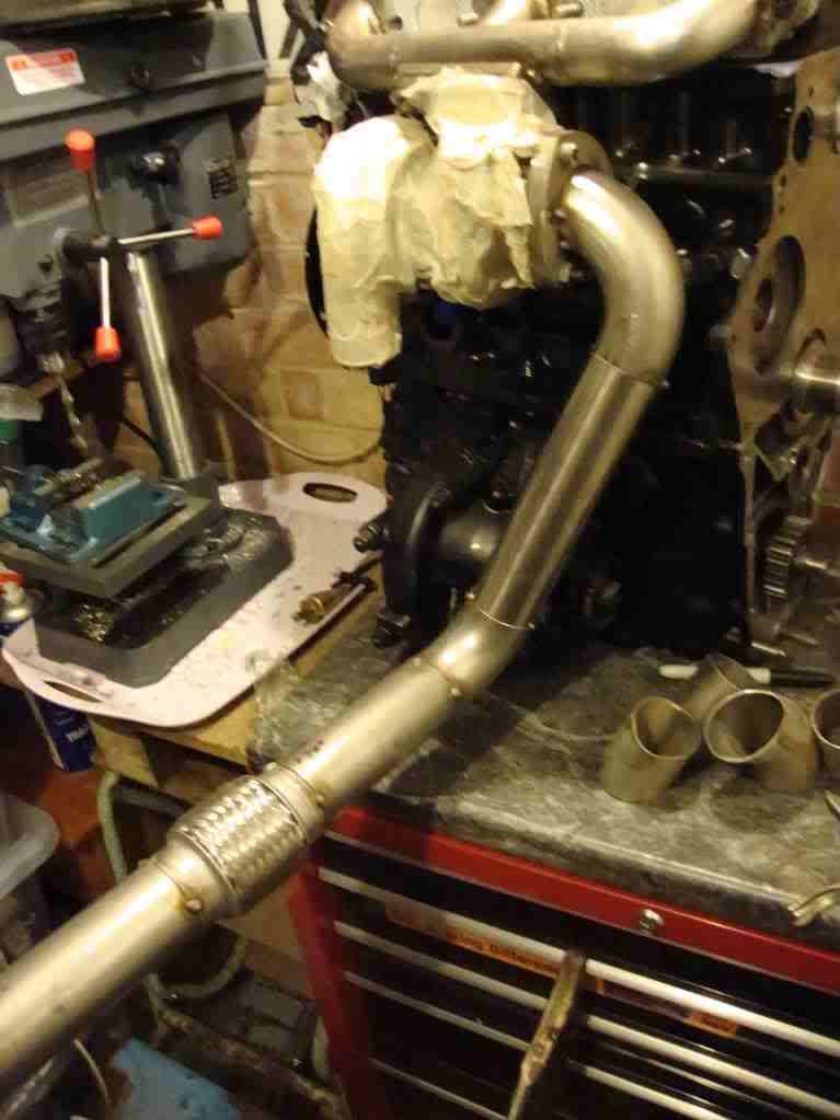

Mine is welded all the way to the ball joint. No leaks, but it's a cunt to get out.

Mine has a slipjoint right after the first 90, easy to reach and make removal of the turbo a piece of piss.
I orginaly did it as one piece and quickly realised a two-piece one would be way easier to live with.

Ok been and sorted it out, its going to have a sleeve joint where the pot joint is, means I can take the turbo off with manifold attached, but should be easy enough to get to from the understand, its getting done tomorrow

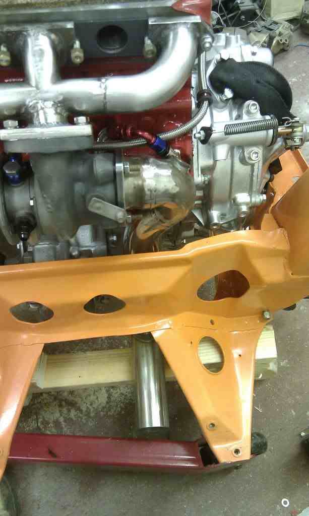

Here's mine. I've been at this on and off for the last couple of weeks. Slip joint with a Mikalor clamp now installed where the gap is

i will be doing my downpipe these coming weeks, since my engine is out of the car. like most of the pics on this thread, how do you guys know where to run the pipes so it all fits nicly once its done? im scared that after its all done it wont fit between the subframe and engine or touch somewhere else:(
any tips?

Just run it nice and close to the pot joint and diff casing bolts, I had to tickle the subframe with the grinder for 2.25".
