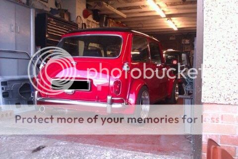

cheers, theres a quick pic of i just after i get it back from the mot station. just got a few more bits to sort now.
dan
