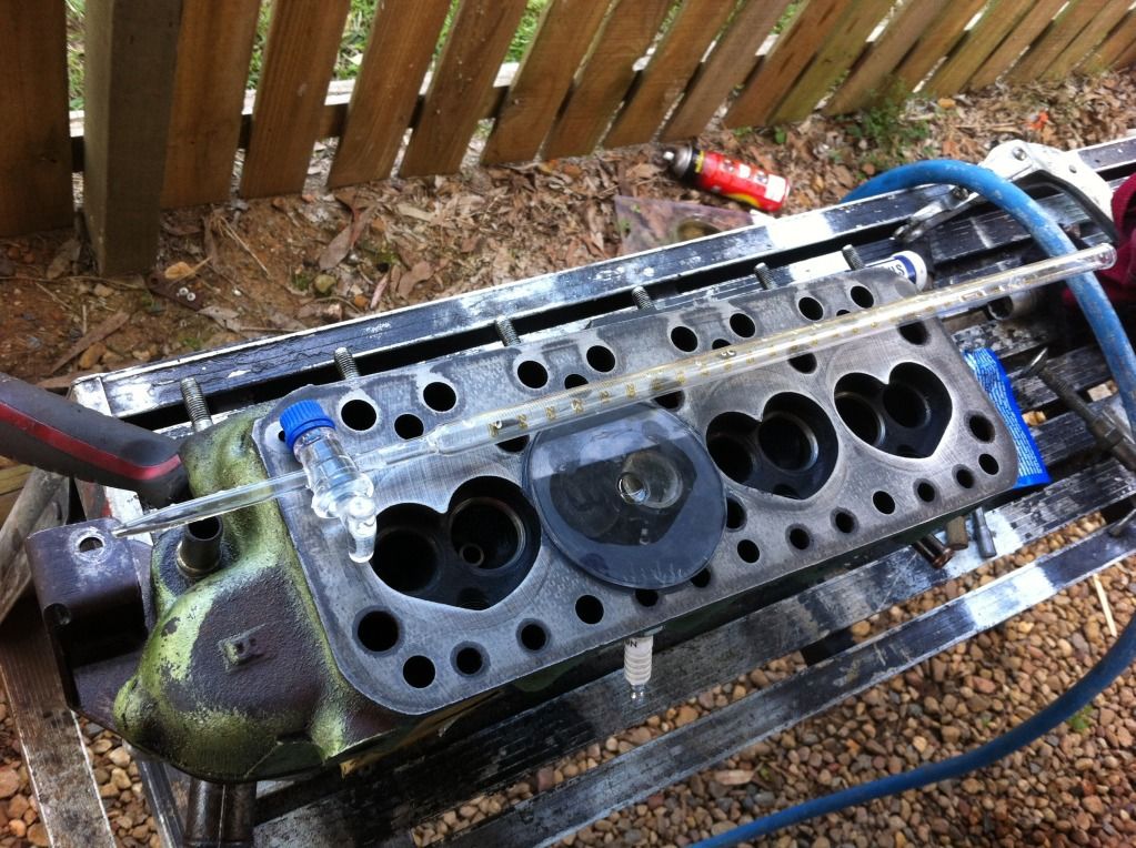

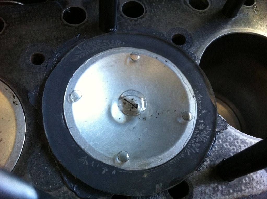

: the head mesures about 25.5cc now
: the piston + space to top of deck is 7cc
: what else do i need to figure out CR ?

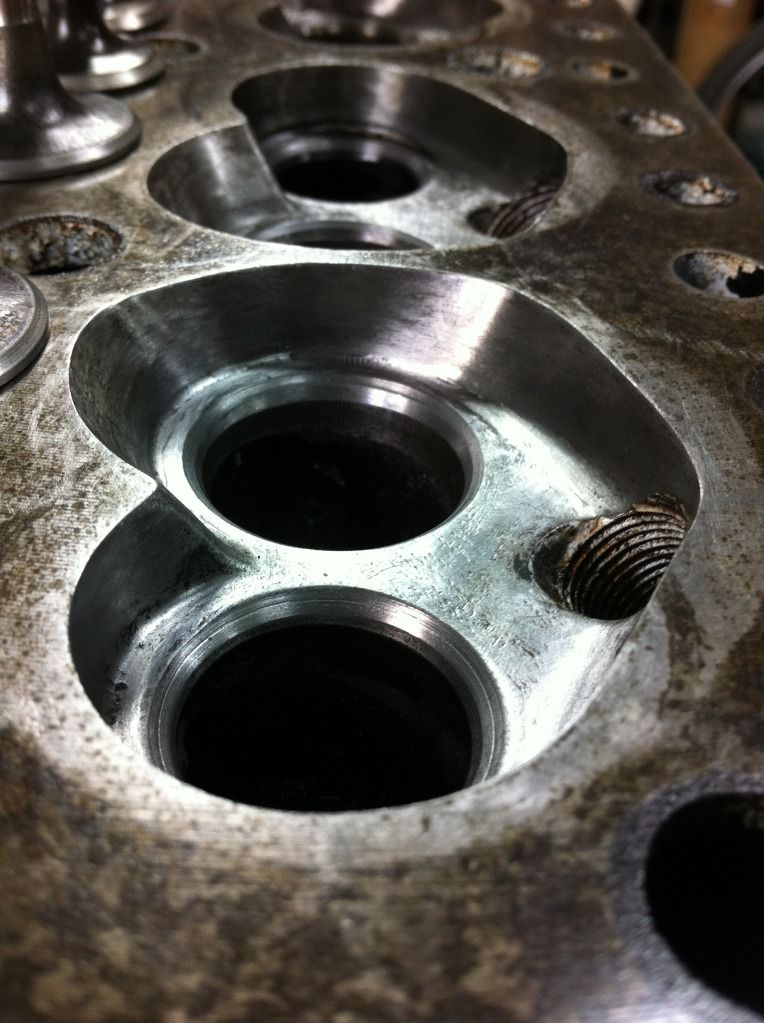

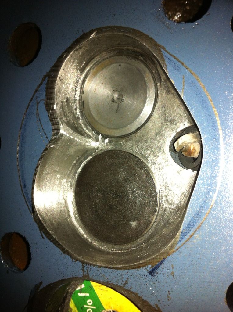

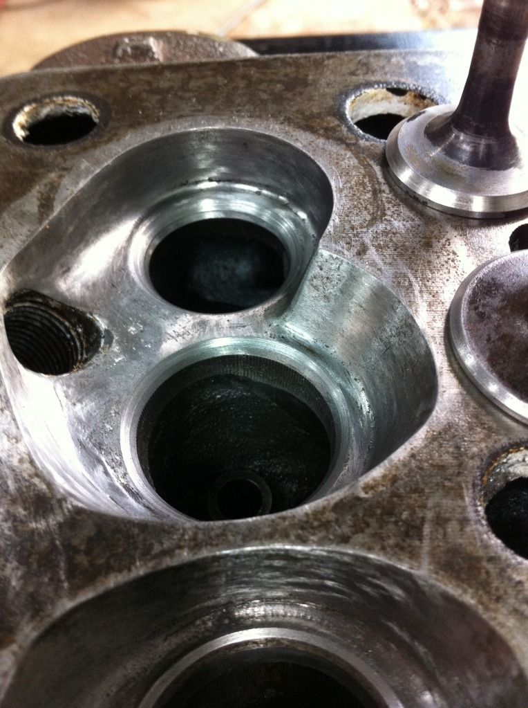

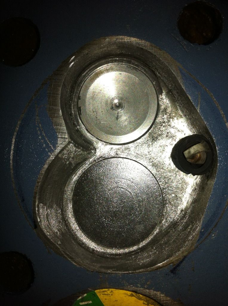

ok so i have ground chamber number 4..
it measures 27.5cc before i started it was 25cc
i have only "removed" material from the inlet valve reign the rest of the chamber has just had a super light pass to "flatten" the sand casting dimples

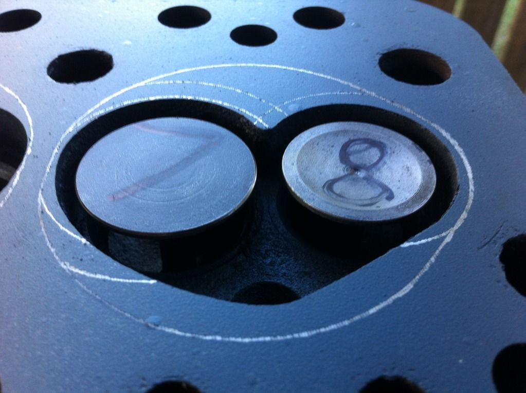

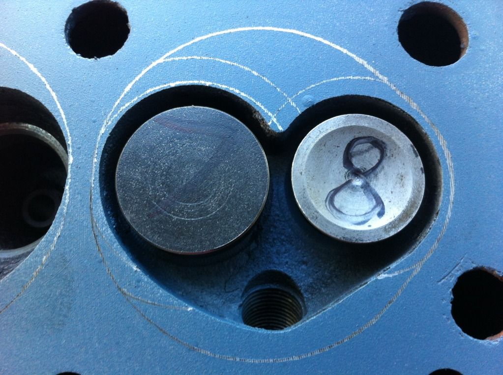

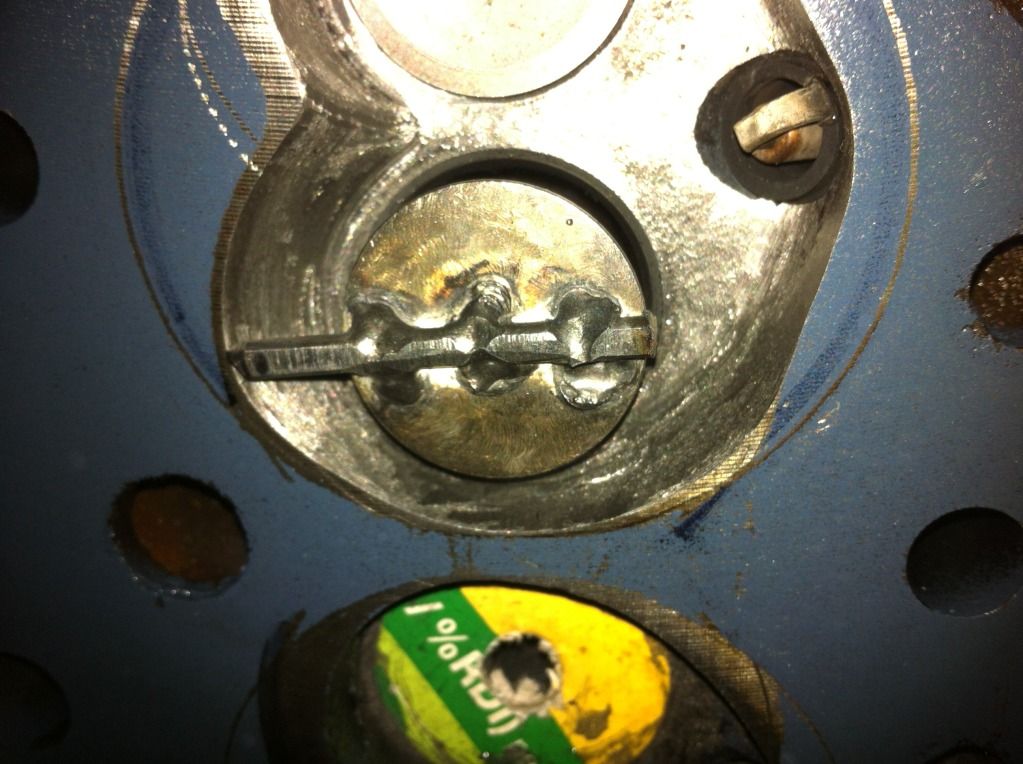

i made a scribe from an old buggered valve by welding a small 2mm rod to it on the flat face i then cut it to give a point to scribe a radius of 0.800" as Davids book suggests.. using this guide i ground it out and blended the sharp lines out i think i am doing good so far.. what do you guys think??
in this picture below i have marked out the intake valve with an 0.800" and 1" radius from the center line of the guide out and i also marked the exhaust at 0.800" how ever i did not grind it out to that line to try save on cc i ended up grinding the exhaust to 0.650" and the intake to 1"
also who knows how much volume the small bore AP250MT MonoTorque head gaskets hold when compressed ?
i measured the bore and stroke to the best of my ability and came up with
Bore 65.6mm (top of the piston says 40) im yet to look up what it should be for a 1098 +0.040"
Stroke 84mm im yet to look up the 1098cc stroke lengh ?
65.6mm squared * 0.785*84 / 1000 = v 283.76cc sweped volume per cylender *4=1135cc
c= block + head gasket + chamber C= 8.75+ head gasket + 27.5 c= 36.25cc
v+c/c=CR
283.76+36.25/36.25= 8.83:1 CR WITH OUT HEAD GASKET 8:1 with a gasket volume of 4.1cc
so if my maths is right i dont need to skim it? i will be skimming it tho as id like to run a CR of something like 12.5-13
Edited by Turbo This.. on 6th May, 2012.

if your using it for n/a then 8:1 will be to low especially if your using an uprated cam, thats what i meant when i said it will need a skim. but 8:1 cr would be a shame to waste it....... get a turbo on it. lol
i think the head work looks good, but im sure one of the TM head guru's will let you know for sure.

Good effort so far, looks like you're on the right track. A small bore head gasket will probably be around 2.8 - 3cc volume I would think.

so useing a gasket volume of 3cc i get a CR of 7.3: and 2.8cc gasket gives 8.26:
the CR is kinder proving to be difficult to maintain accuracy

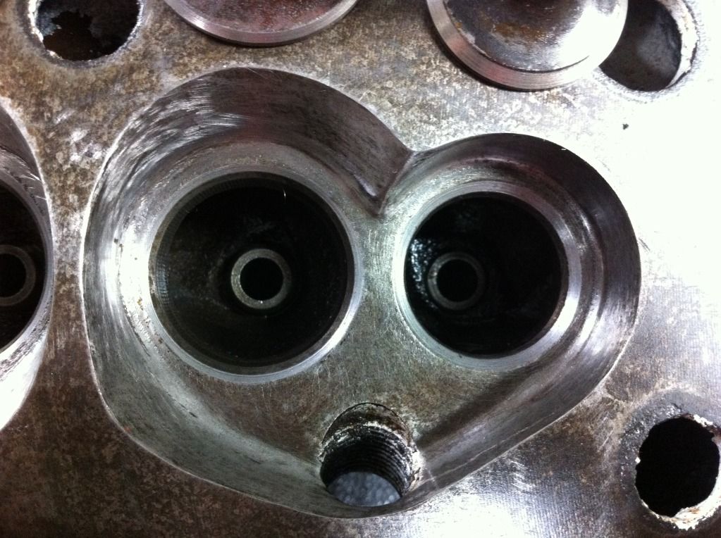

well i have been busy with work (installing solar electric systems) so the mini has gone no where how ever i have the day off tomoz so i plan is to get my electrical license sorted as im fresh out of tafe and just need to do paper work after that i need to ring around for new suspension bushes for the work ute as they are almost non extant ! its a 87 model Toyota hilux then if i have time i shall do my dammed to finish the head get it the the shop for a shave and all that fun stuff im having withdrawals from not driving the mini !
Turbo This..
1767 Posts
Member #: 9165
Previously josh4444
Australia, brisbane

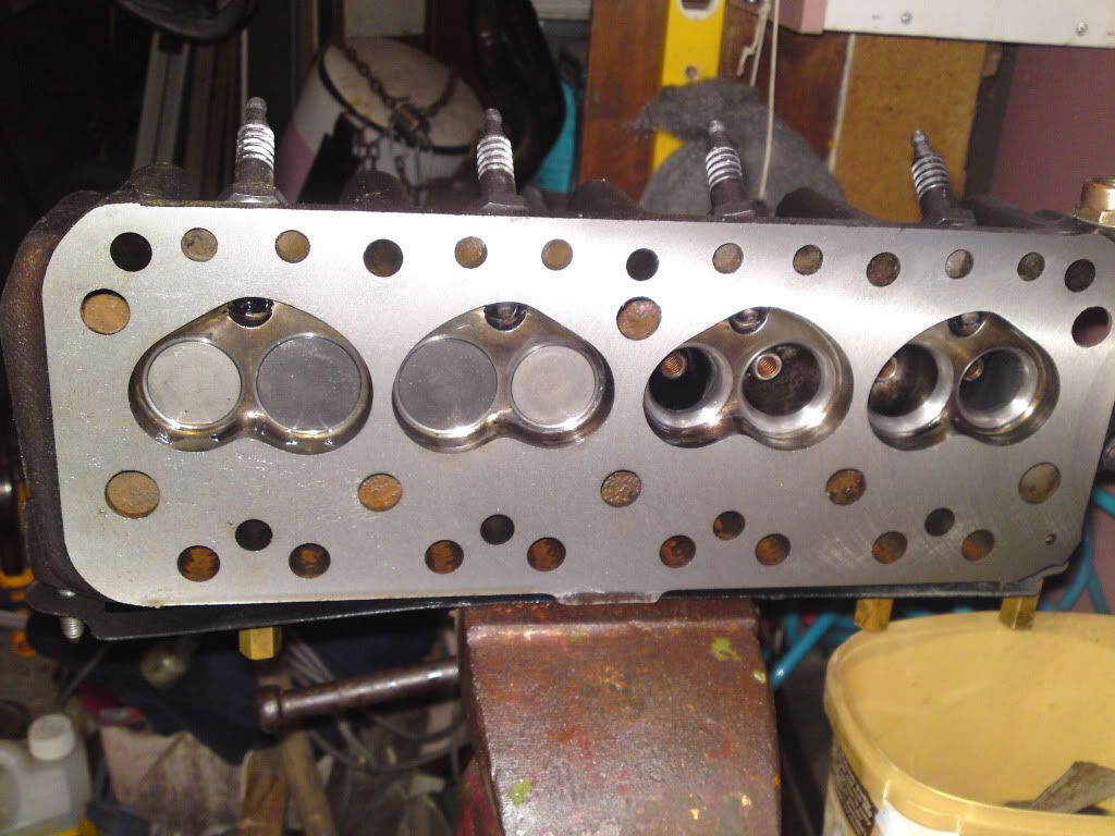

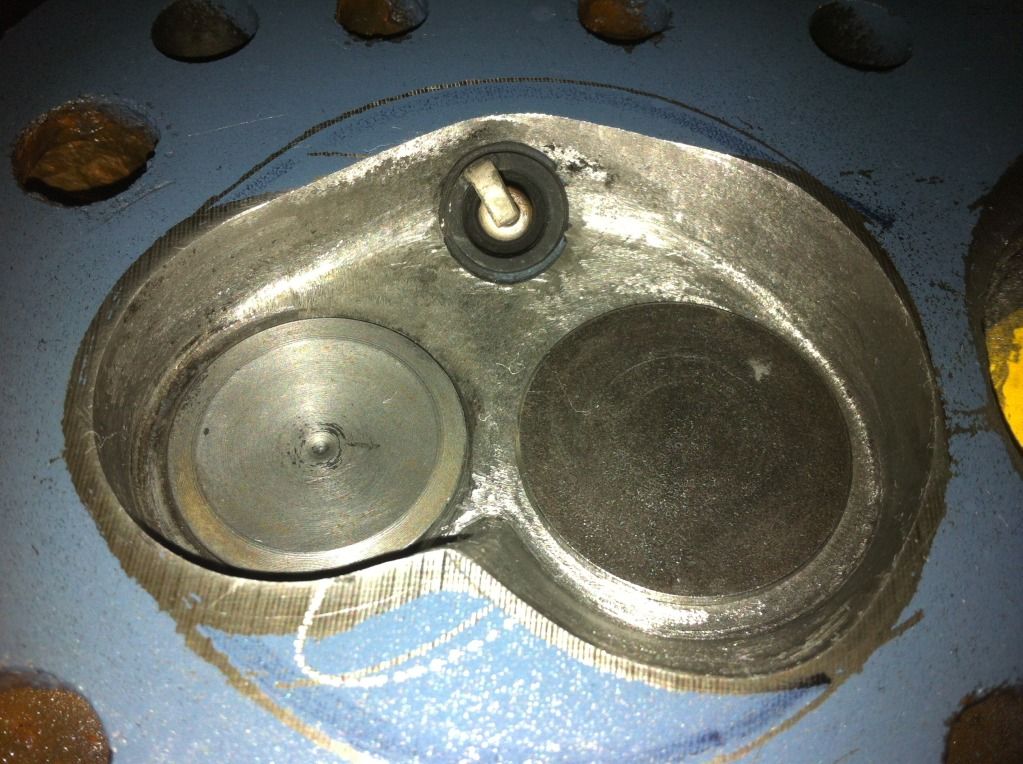

well i got my sparky license sorted =D YAY!
I also got the mini head sorted YAY!
Quite chuffed to be honest im happy with my effort for a first timer.. the chambers all measure about 28.5cc it will be interesting to see how equal they are after the head has been skimmed hopefully not to bad i think ill need about 12.5cc chamber volume to get my 13:1CR but that might be hard so may well just pull the lump and fit some flat tops and a zero deck that should give me 20cc in the head to get 13:1CR dono im much undecided..

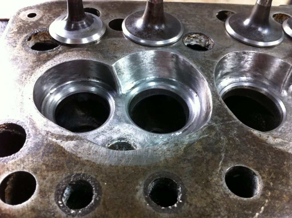

I had in mind the beak radius needed to be bigger than the way you did it.
Maybe I am wrong.

advantage: yess i think your right now that you point it out i had another read in the book and it recommends a 0.18" radius so ill have a measure and see what i have and fix it if need be = D thanks for the heeds up i would have missed that if you did not point it out..
4642 Posts
I agree, a slightly larger radius is needed. Other than that it looks a good effort.

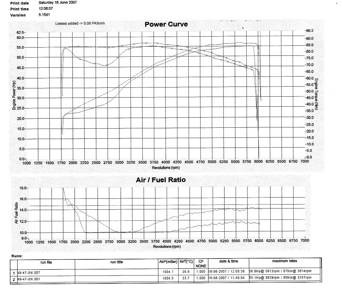

found a dyno plot of a 202 headed NA with (I did a head for a long time ago. just bigger intakes std ex and limited porting sw5cam on a stf 998 bottom end) did another with a lot better porting on a 80+ block that made quite a bit more power (68 bhp with a +80, 998 sw 5-07 same dyno.. more than most ''tuned'' 1275's make on the same dyno)
