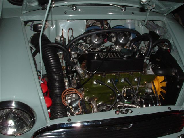

Are they twins complete with manifold and linkages? or just 2 hs4's?
I have twin hs4's on mine and it goes really well but mines a 66 mk1 and i wanted the old school tuning look.
A hiff 44 would be an easier option for tuning.(I have one complete with mg manifold if you want to swap?)
