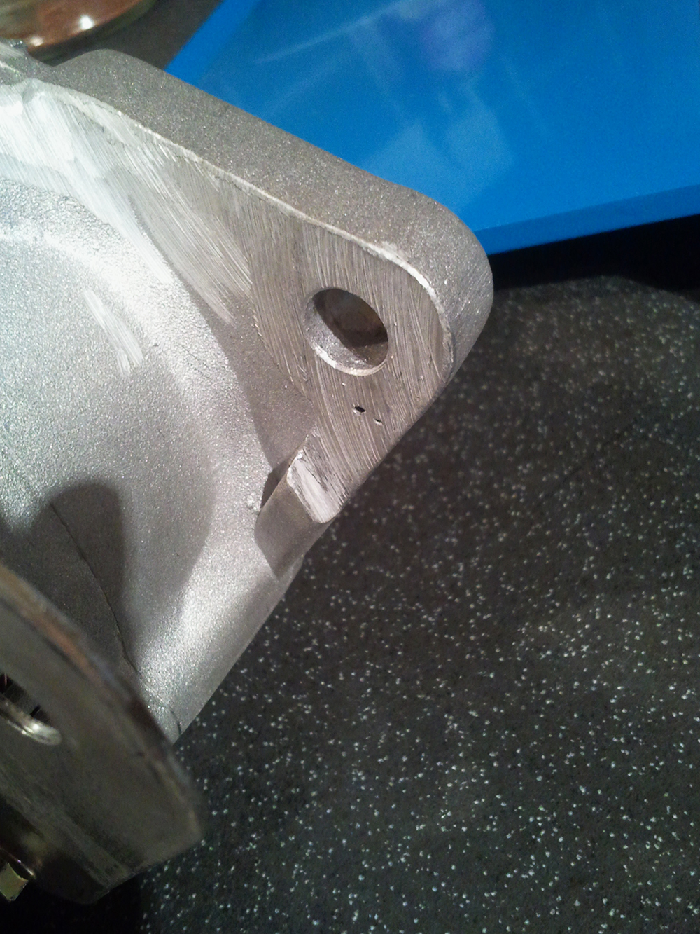

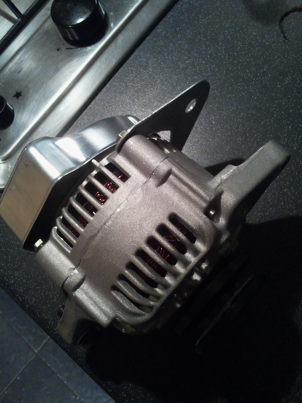

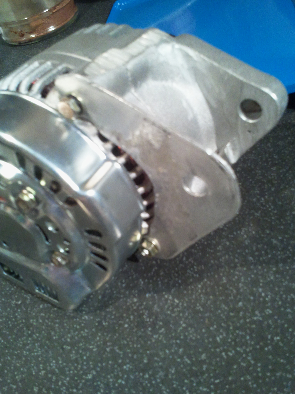

Mine is ready to bolt on now just need a long bolt for it i had to modify it slightly as the case seems different to a few build threads i looked up. First attempt was a mount/adapter bracket cut out of 2x1x7 inch ally it was rather flexible so i bodified the alt to fit the normal mini mounts
bare with me im on the phone pics will take some time..

its just a bit of aluminium of cut mate with 3 holes drilled in it, i would make you one but i have no more ally

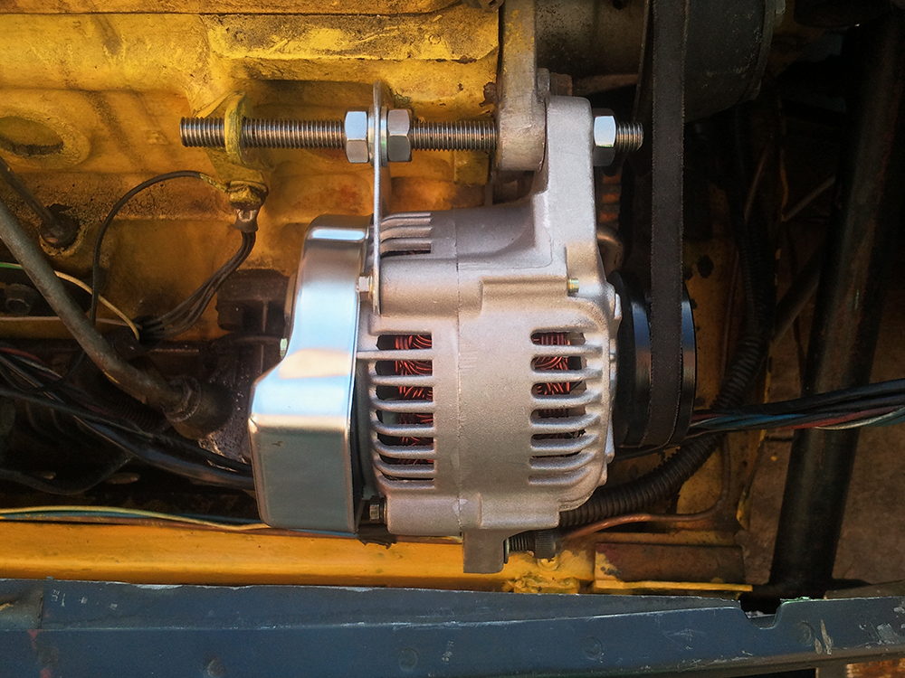

For a long bolt, a head stud fits nicely.

Just fitting it now i ran a tap through the water pump this should stop the bolt coming out again lol
