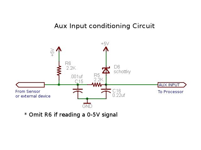

I have both the Uego and v3 MJ, how can I get the MJ to read the output from the Uego?
I've had a quick read on here: http://www.autosportlabs.org/viewtopic.php...ight=uego#10347 and it seems pretty involved.
Wondered if anyone else has done it?

I think its as simple as connecting the 0-5v output on the uego to the mjlj
On v3 you need to knock together a separate little board.

unfortunatly that image may as well be in chinese because it doent mean anything to me

i think mines a v3 and i have it all wired in and working....not a fucking clue how though sorry, try dropping a PM to Anton, he did mine for me :)
