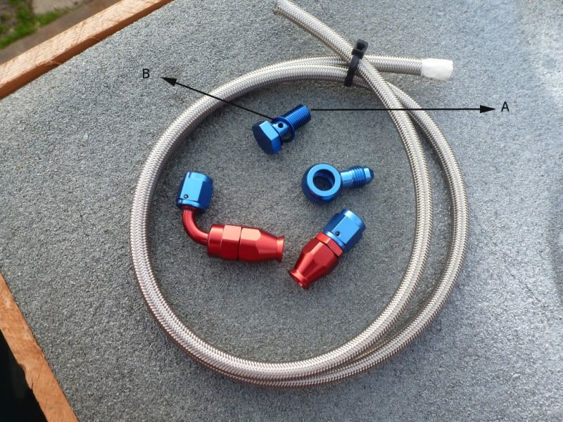

hope you dont mind..i used your pic. basically need to know the size of the oil inlet (B) and oil outlet (A) on the banjo bolt in millimeters?
i just machined out the bolt..so i need to drill out the appropriate sizes on the A&B points of the bank bolt..

I never measured, I know the thread is m10x1, so around the 10mm mark, there only about a tenner to buy the banjo and the bolt, but of course it means using braided and fittings instead of welding 8mm pipe, here's the links anyway

my feed line is 'dash'4 AN and is 4/16ths of an inch so anything bigger than that is more than myself and benny run
