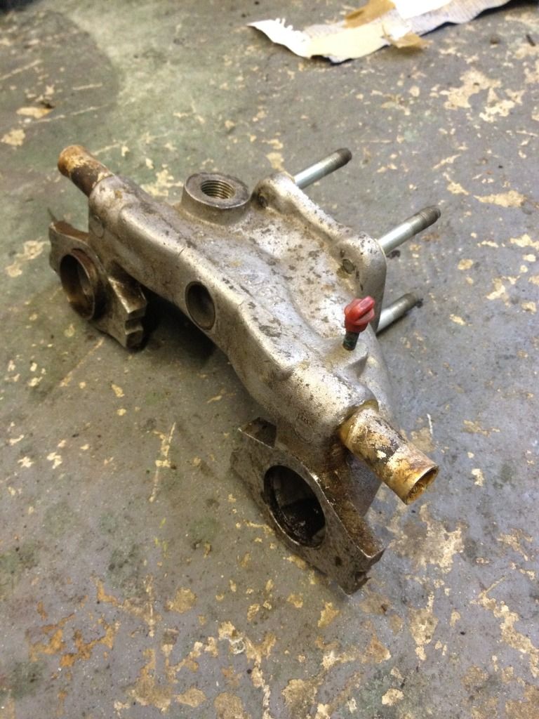

thanks for all the replys! removed the rest of the block/gearbox/flywheel and have noticed that on the crank the tapered section (flywheel end) ahs been butchered in the past will will i still be able to use the crank has anyone else come across this problem??
supermotolee
614 Posts
Member #: 2153
kings langley
use some fine valve lapping paste on the taper of the crank lap the flywheel onto it then re check the condition, sometimes it can look worse than it actually is...
Can you put up a pic of the butchery for us to see?

wow great responce thanks for all the spec Robert, that crank looks like this...
http://i1000.photobucket.com/albums/af127/...464/photo-1.jpg
That crank is scrap.

nasty mess a!! cant belive someone would/could do such damage! and then put it all back together and run again!
