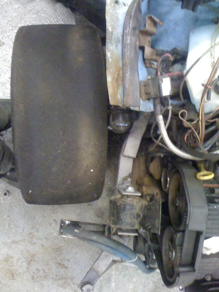

mind if your aiming to reduce scrub radius while keeping a sensible KPI a side effect will be narrowed front track if you keep your current upper arms. As a result of this i cant run coilovers with slicks, but could probably *just* manage with my 195 road tyres and carefully positioned brackets.

There is no optimum layaout so to speek as each would be depandant on wheel and tyre used,
for instance as i'm sure you understand a narrow tyre would benefit from some roll induced camber Ala standard setup, but a 10" wide wheel with matching stiff carcass slick will want almost none,
the frame i am working on for my next car will be a wide track , i will be pushing the hubs out 100mm between them , then offsetting the wheel back into the car,
