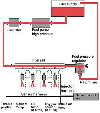

Hi, I'm installing my megasquirt at the moment and have a question: Can I use the mg metro fuel pump and regulator for injection? How do I connect it? Kind regards, Remko fuel pump yes quite sure you can as it is used on other efi cars as standard regulator no you need an injection fuel regulator the pic is a generic one off google but points out the correct setup Yes i moved to the darkside |

The google picture omits one important point - although a fuel injection regulator should be at the end of the fuel rail as show (ie, after the injectors not before) it should have a third connection, a sensing line, connected direct to the inlet manifold/plenum so as to maintain the fuel pressure at a given pressure above manifold pressure.

Is it ok to use any injection regulator. I have one on the shelf of a 205 1.9GTI. Can I use this?

Yes,

You can use any injection regulator so long as it has the third connection back to the inlet manifold/plenum - without it, it can't regulate fuel to a constant 3bar above air pressure.
