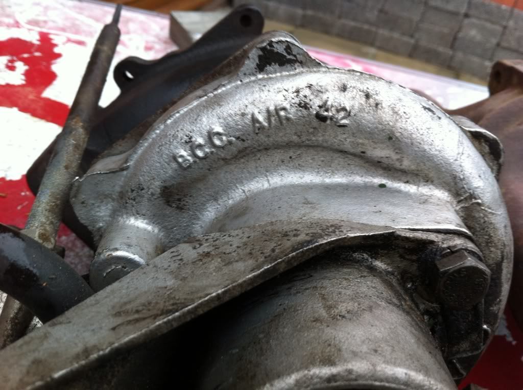

Just wanted to double check that these are t3s?
Thanks very appreciated
they look like T3s from the pics. a shot from above would confirm it
bennyy
2233 Posts
Member #: 9037
Doncaster, yorkshire
Yeah they are t3's.
