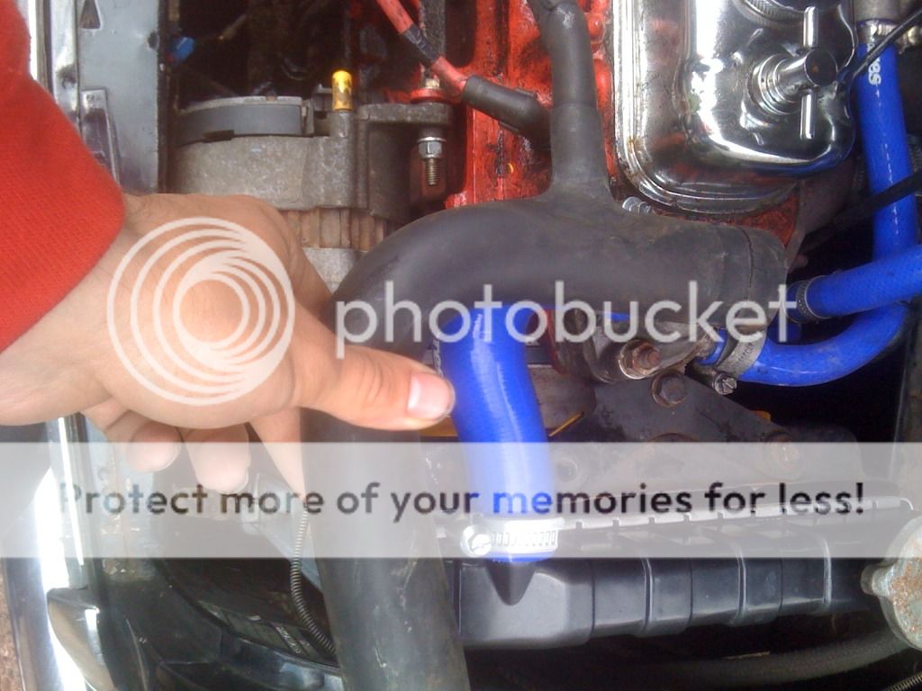

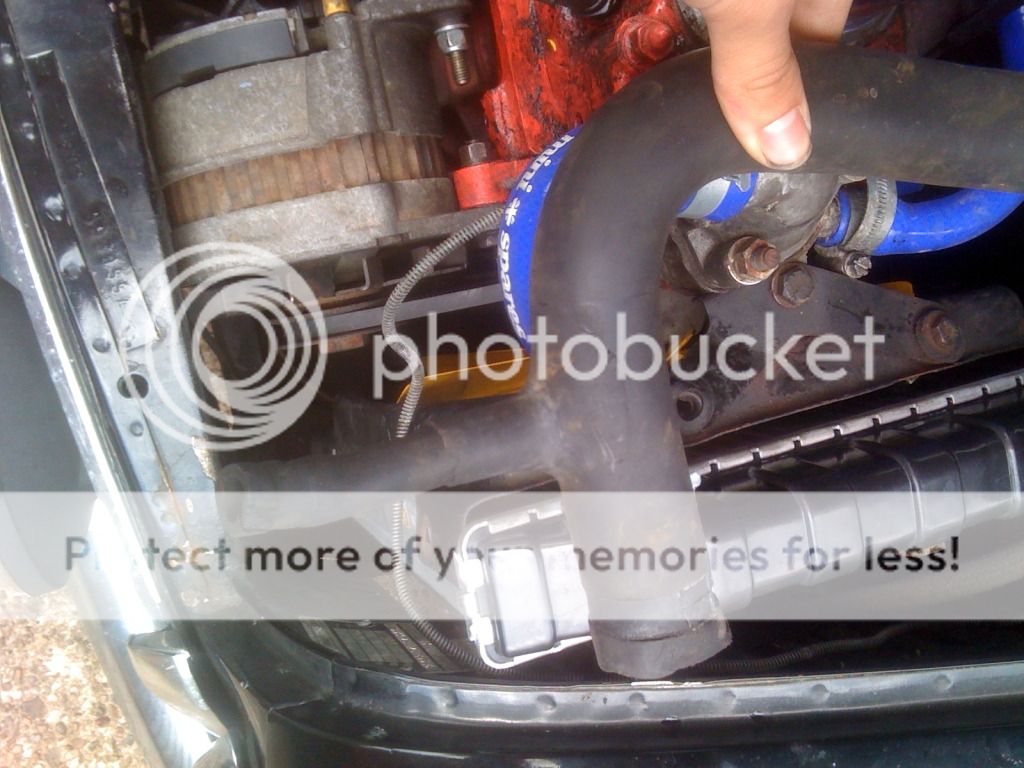

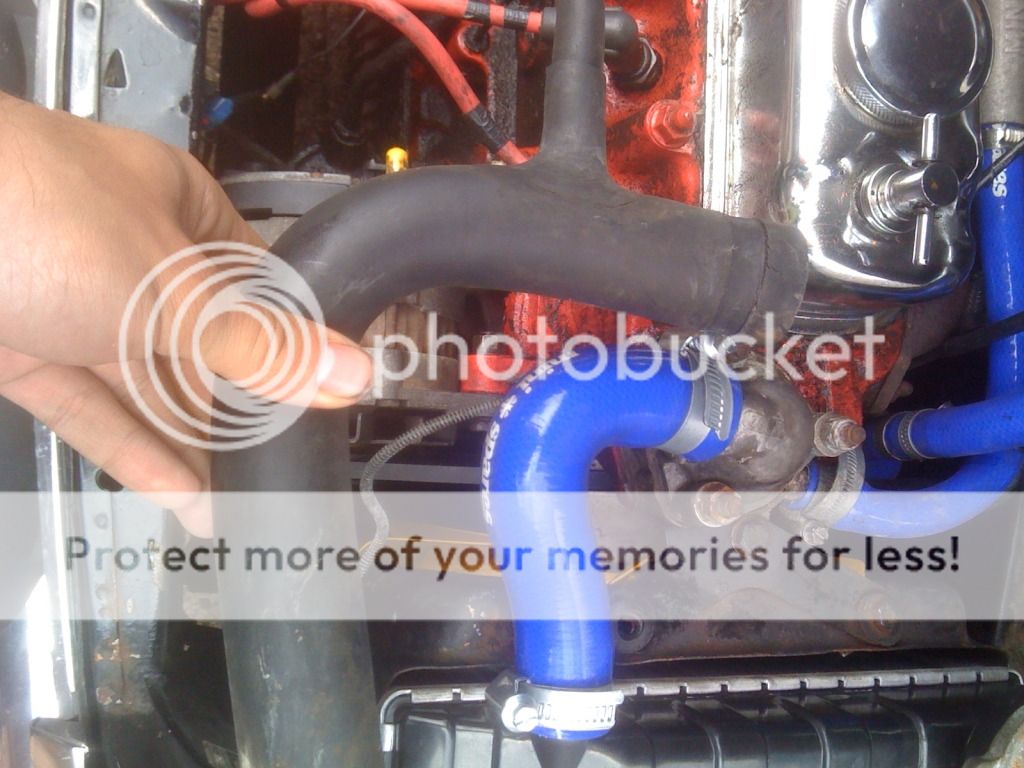

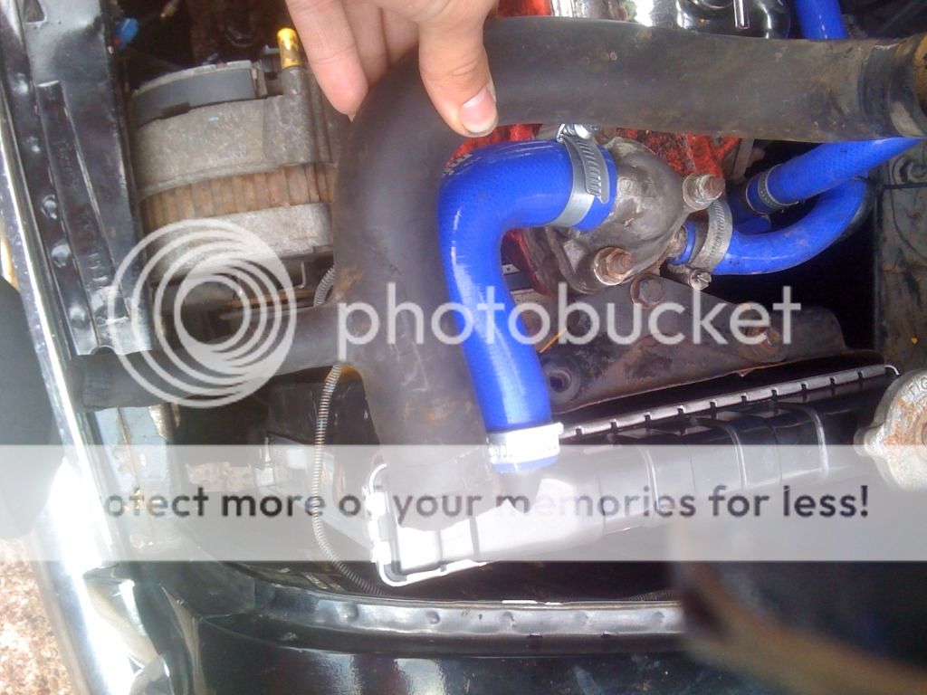

1492 Posts Member #: 9468 Post Whore Wootton Bassett |
13th Jun, 2012 at 12:01:39pm
just been out and took some pictures of my house mates mini and old bottom hose:
Edited by Craigie-B on 13th Jun, 2012. On 10th Mar, 2012 theoneeyedlizard said:
Hypothetically speaking, where would you stick your nozzle? On 22nd Jun, 2012 apbellamy said:
my wife doesn't know what.head is never mind compression ratio. |
13th Jun, 2012 at 12:18:21pm
So to get things straight, the water comes out of the bottom hose, goes up into the water pump pushed around the engine and then into the cylinder head then to the heater matrix and returned into the bottom hose, but some of it goes up the top hose and into the radiator?
