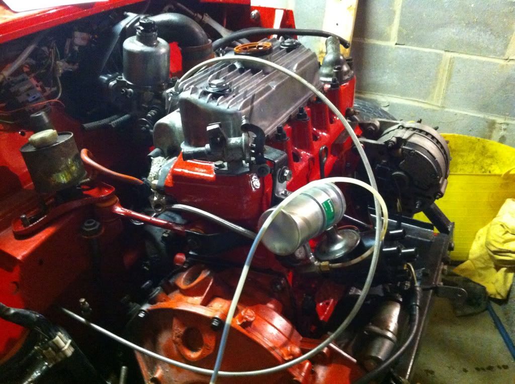

Hi guys another daft question.
I have fitted my carb and plenum chamber tonight and the plenum chamber is touching the bulkhead, I will probs rattle. Is this a common problem? I think I need to get an adjustable engine steady to angle the engine slightly forward?
What you guys think? Cheers

Yep adjustable engine steady and lean it forward a bit

Or a Birmingham screwdriver, but you bulkhead looks too nice for thios approach!
If in doubt give it a clout is the cost effective option *wink*
Or get an adjustable rose jointed steady off Mr Austin.
On my clubby somebody went to town and made a little plenum bulkhead box!
I have one of these, shame it's not on car adjustable though..
