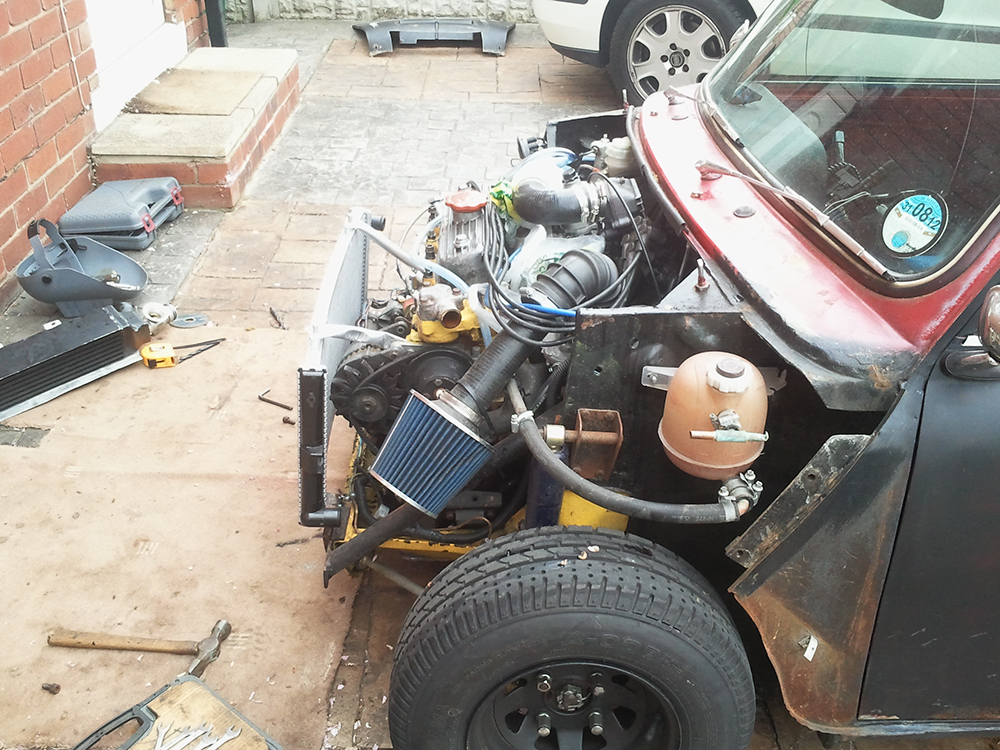

I've done a bit of research but nothing confirmed; I,ve mounted my ford coilpack on the brace bar which replaced the inner wing. I'm trying to identify a set of plug leads that would suit this position but none of the manufacturers seem to issue lead lengths in there literature. My local factor has been next to useless as well and is only interested if I give him a reg number of the car they are for!.
So, if you mounted the coilpack on the inner wing area, which lead set did you use?

mine are from a ford ka you can just see them they go from the bulkhead behinds the rocker in this pic
I was thinking the same!
