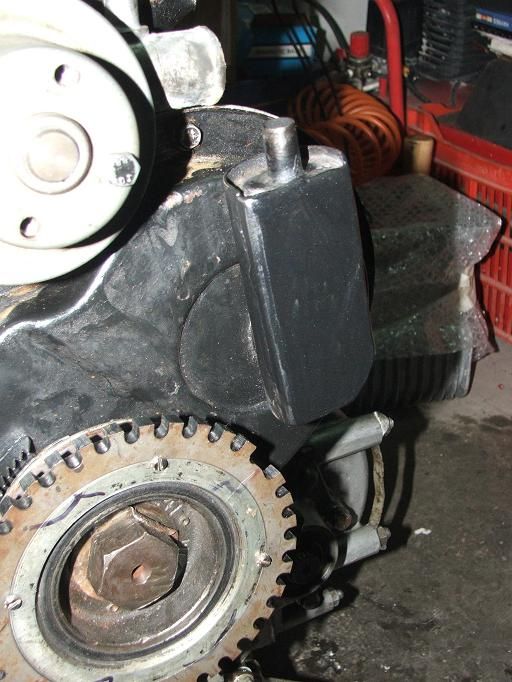

Went to fit it and this is the case:

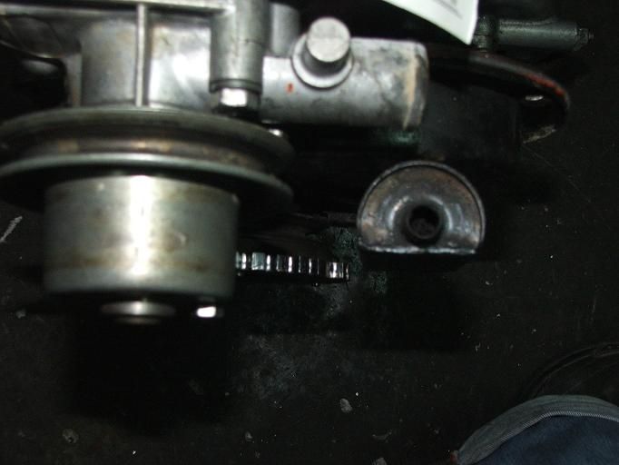

So put some longer bolts and 2 washers on each and its like this:
What am I doing wrong? My housemates got the same fan and it fit with just using the spacer?
Is it okay to put a third washer in? Seems a bit silly to me :/

just to add to this some of the blades touch the breather and some clear it? How wierd?

Looking at it, you would be better off with a flattened breather

I havent got any more timing case gaskets :/ I waas hoping to get engine in car tomorrow
Old trick is smash the breather on the timing cover flat.
Take the fan off, and take the hammer to the breather. Simple!

ok, fans already off lets bust out the hammer :)
is it fragile or should i give it some proper wrath
Hit it as hard as is necessary to clear the fan, don't go paling the crap out of it straight away lol.
Put something behind it if you can for a bit of support.

ok thanks buddy :)

could use a different sized spacer

I have the same issue Craigie, if you put a spacer you need to modify your top radiator bracket, and is a pain in the ass to fit the radiator with the spaver in the fan!!!
I modify my timing cover, but for that you need a new gasket...

P.s when I brought my mini My spacer was between the waterpump and the water pump pully so it cleared it that little bit more not sure if this was wrong.

ahh okay, well it fits teh engine so far I will try hold the rad against it tomorrow and see how it is, if it catches then I may have to chop the breather. The top bracket I was using is from a 998 so will need modifying anyway :)
