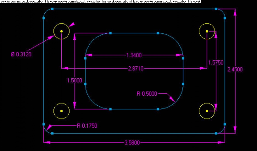

have found some rather cheep T2s and got the flange mesurements if someone could possibly tell me if there the same as R5GTT (is it just standard T2?)
its going on a mirage manifold.
thanks ! Dan

check this link
http://www.turbominis.co.uk/forums/index.php?p=vt&tid=3274
but they seem about right, yes standard t2/t25 flange
