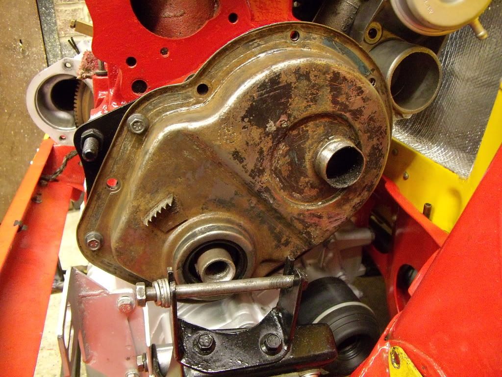

Can't you weld one similar to how I did mine, welded that one with stick ok..

Alan, did your cover not warp at all? Can't believe you welded something so thin with a stick.

No did not warp, for doing the job with stick you have to use 1.6mm rods, takes a bit of practice, yes i have used stick to do all my welding, I haven't got a mig..

What you can't see from pictures is i cut the old barrel filter off leaving the flange still in tact, so there was no direct welding to the cover, a picture to show what i mean..

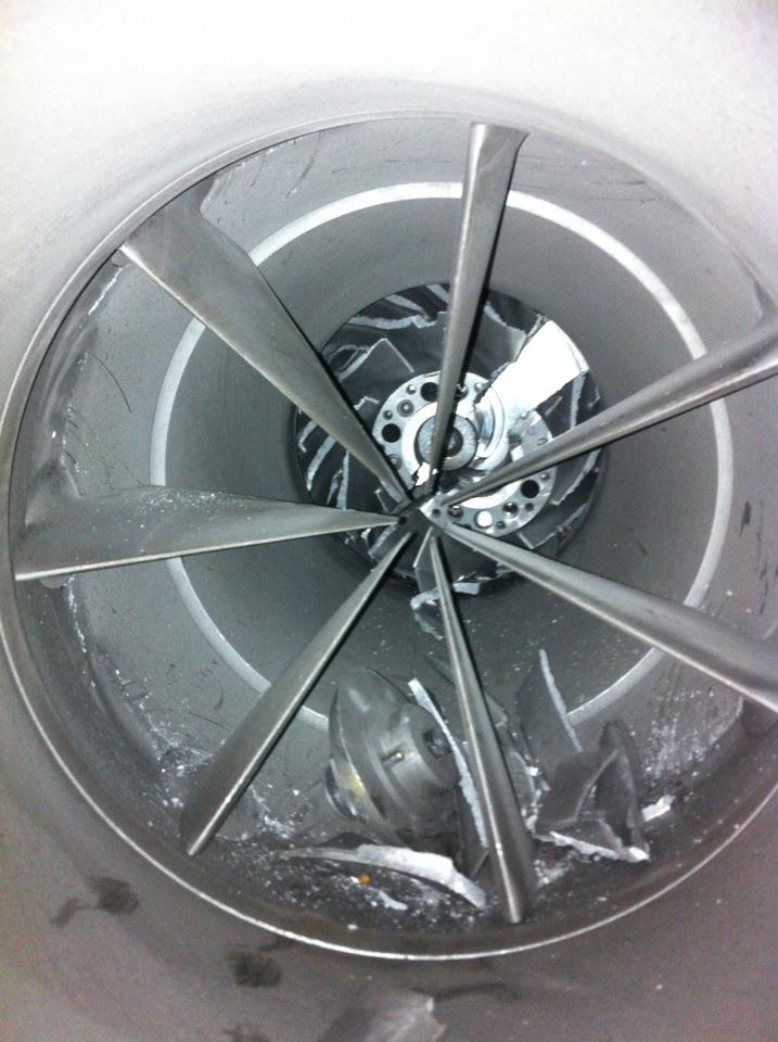

Nice effort, but no where near as good as the one we've experienced at work recently:)
and to give you a perspective on size, here is a GT1752 compressor wheel next to a similar wheel from the above machine *happy*
BANG! comes to mind *hehe!*
Edited by Sprocket on 20th Jul, 2012.
video to follow, but sausage and wheelie bin spring to mind...
