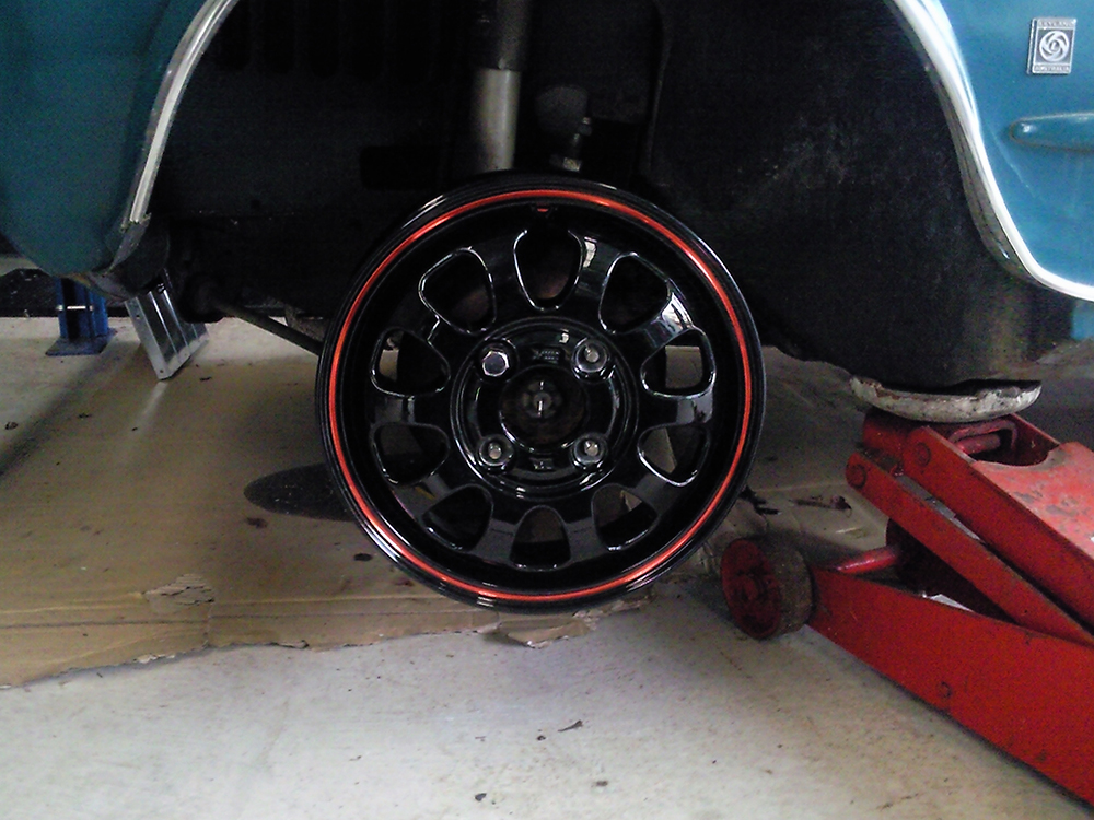

I have been given these rims to buy; they are 12”x4” with a plus 42 offset and 100mm PCD.
Can you please help me with what tyre size, clearance problems and if they just look any good on the car.

mini is 4" pcd so they don't fit.

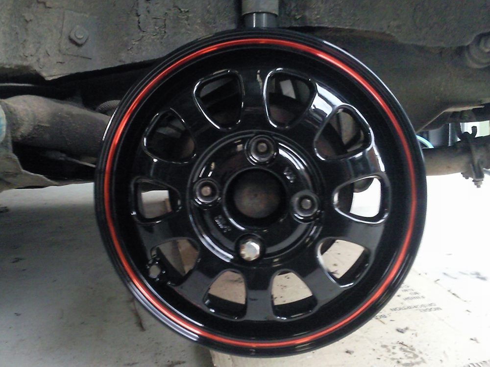

they bolt up so sorry i got the pcd wrong. im not that swithed on with rims.

Pcd is wrong but you might be able to use some specialist washers to make them fit.
Offset is high for a mini by the look of it but could possibly get away with it depending on the application.
Finally, a 4" rim is narrow. Cooper alloys are 4.5"as an example
I do like the look of them though

as rob says, they are very narrow, look ok tho
i think they look crap! i also would not use wobble bolts there a bodge imo
I think they look ok, but too narrow, and you need to check the PCD if you are to use them.

i think they look good but as above maybe a bit narrow
Done now needs redoing lol
You're a brave man jacking your car up there, I hope there's no engine in!
I've seen many a floorpan bent by being jacked up there, it's bad practice. I won't even do it without an engine just to be on the safe side.
15300 Posts
They are the wrong PCD to use safely on a Mini, and this can clearly be seen in the picture. Look like a VW wheel to me so 4x100mm NOT 4x4" which is what a Mini uses.

i have found out the pcd on those rims and they are 100mm x 4 pcd and they are designed for a 1980 models subaru sherpa. some little jap city car. i wont be using them.
