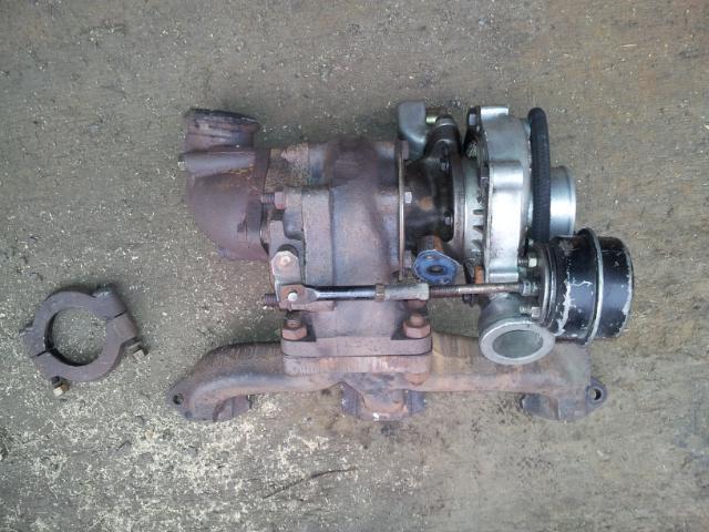

Morning All,
Just wondering if anyone knew how i'll connect turbo to plenum.
I've noticed that it has a different setup to my current turbo which has blown. It doesnt have the plenum attachment on the turbo. How would i connect it from the turbo - plenum chamber?
Also the UNF size for the oil feed into the turbo is different, the one I have isnt compatible.
Thanks James.

longer silicone hose?
Done now needs redoing lol
That's interesting, a T3 hybrid. As above you'll need a longer silicone hose.

That's the one from the for sale section, I thought the same.

Looks like my old one. I used an eBay oil feed which bolts on with the gasket.

Cheers guys - Will look into getting a longer stepped hose this week. And bigger union to fit the oil feed hose and turbo inlet oil.
Does the T3 (MG Metro) and T3 hybird vary much wil_h?
Who knows? It depends what it had been hybrid'ed with.
As above, depends what the hybrid was built to do.

Have a look on the exhaust housing to see what size it is .25 , .36, .48 etc You could also remove the compressor housing and measure the compressor wheel to see what trim it is. Maybe it's a Rs turbo unit, in which case it's a nice upgrade over standard. Ron
