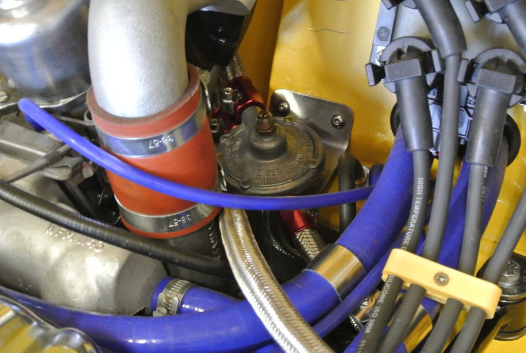

i was just wondering if the lip below were the washer bottle goes is too close to the turbo or not for the regulator no pipe seem to touch? any thoughts are welcome

Usually just to the left of the wiper motor
IMO to the right of the water bottle mid way. So the pipes route is a straight shot away from your bulk head box

but thats where the wiper motor is lol, sorry this is an old pic everthing is back in the bay now with just the regulator to find a space

Mine sits right under the scuttle, I know Brett has his pretty low down

yeah mine is next to the tower bolt
I would alter the washer bottle position to the left hand side somewhere? All will become obvious. When you start to fit the reg and pipe work
like this....

ah i see with a bracket not close to the bulkhead

Put my regulator here, if its any help.. Alan.

when its sitting there its easy to ajust :)

have you had any issues with heat i think im putting mine just a tad more to the right than yours but same area. hopefully shuold be going for a start tomorrow

No not so far, Ive only done about 70miles since I converted to turbo, and seems to be ok.. Alan.
