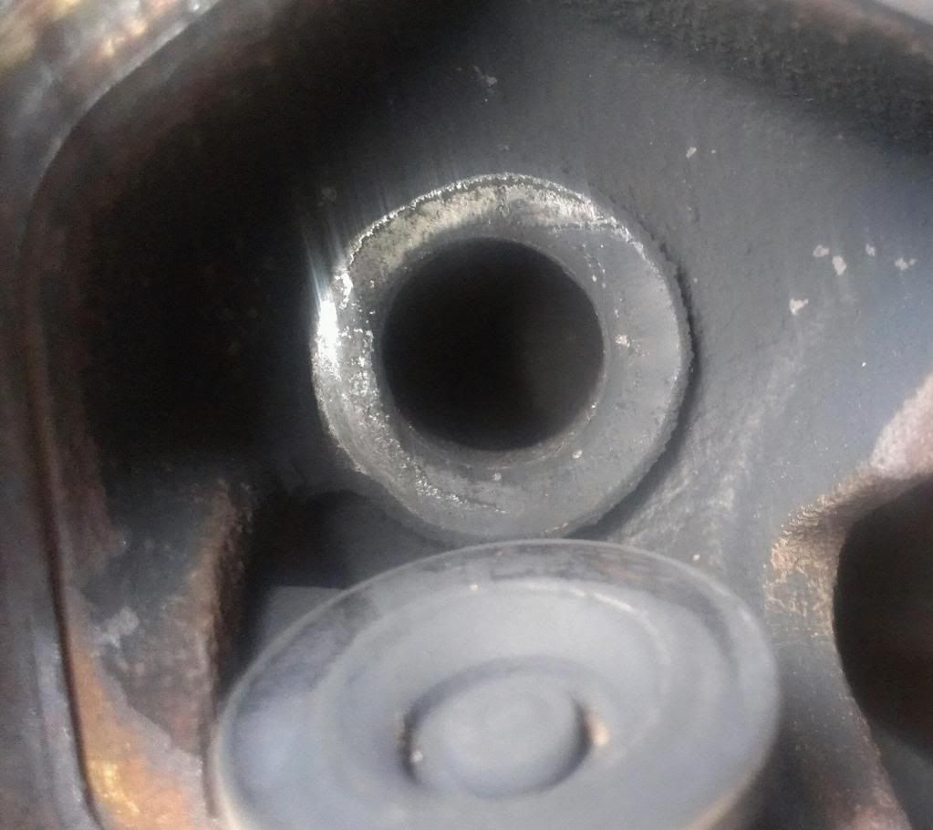

This was just done on the gt2056 to allow the boost to be reduced to a sensible level.
It won't net you any bananas I'm afraid.

As above, just done on the gt20 to control boost levels
Before
After

It's basically a valve that controls boost levels, by diverting gases away from the turbine to control its speed. As standard on the gt20, its not large enough, and couldn't flow enough, so was causing it to boost spike.
The standard manifold and turbo elbow can be ported with good results, benross or turbo Phil on here can do this if you don't fancy s go yourself. Have s search.
