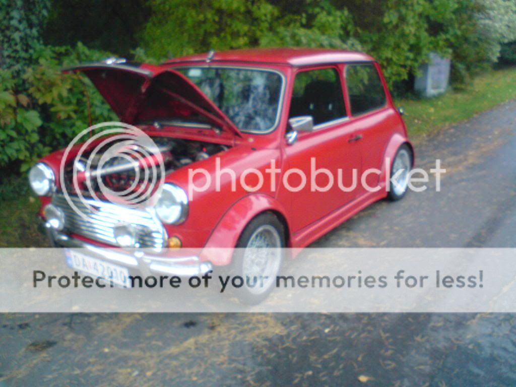

well engine was running fine done a few miles since being in the gtm. Then the other night it, when slowing down it cut out. then would only start with foot on the throttle/ choke out. Drove home ok with keeping the revs above idle kind of speeds. Reading lean on the AFR. plenty of fuel getting to the carb.
Will only start on choke and revs quite high, when choke is in revs will drop, struggle then cut out. Could this be the inlet manifold leaking? there is a slight leak on the exhaust middle branch.
engine is on megajolt and ran fine when in the metro.
