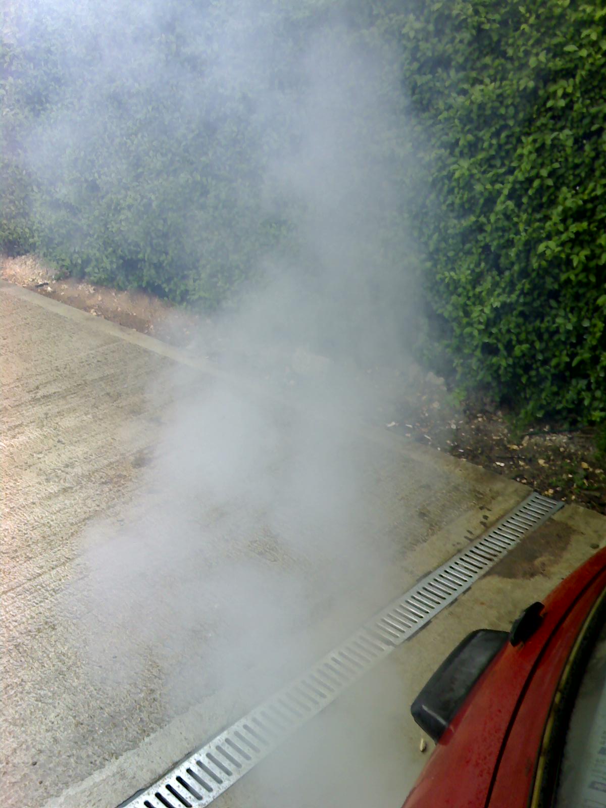

this is a pic of my first turbo engine, blown turbo seals caused this
actually this was a brand new turbo but the oil seal for some reason leaked

Brett - looks a lot like that but not quite so bad!
Would turbo seals give me that intermittent smoking? Wouldn't it leave residue in plenum?

not in the plenum, this is oil straight into a hot exhaust, exhaust gas turbine oil seal is the one im thinking, and the one in my pic was at a rate of about 10l per hour.... *surprised*
