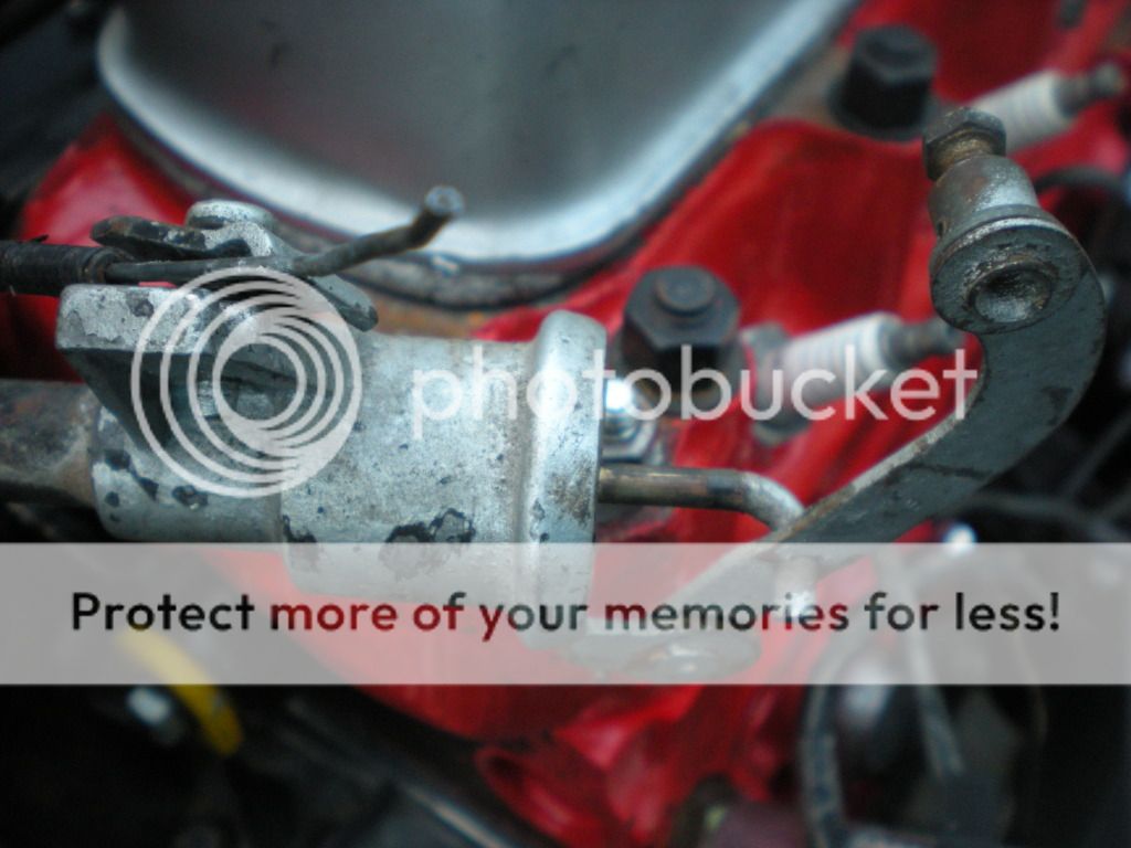

Hey guy, went to attach the heater cable tonight and I think I need a metro one?
Can anyone confirm the mini one is too small for a standard turbo head and heater valve please:
Also is the standard mini throttle cable long enough or do I need a metro one aswell? I broke it today and so want to make sure the one I replace it with is going to work.

Carb and heater thingy are both in the same place so standard length cables should be fine.

Oh, mine isnt *oh well*. Mmmmm on the 998 the heater valve is in a different location its pointed forward instead of to the side?
Bit more research needed i think
the original heater cable should be ok on the assumption that you are using the same tap; IIRC the taps are in a slightly differing position between 998 and 1275 however I've never had to renew a control cable
Depending on the original car spec, the HIF can have a differing locating thingy where the throttle cable sits on the retaining plate; again will still be the same length though

Yeah the tap is in a diff spot, will have another play tonight.

The metro doesn't have heater cable in the engine bay, as the heater setup is completely different.

these normally get snipped as you catch them quite alot when working in the engine bay and are rather sharp i had to buy a new one too as mine had been cut but there only cheap
Done now needs redoing lol
Why not just trim some off the outer?
Thats great if it's long enough to begin with, but the whole topic is about it being too short. Picture even shows that.

Measured my cable 28.5" minispares says standard one is 30.5" or something like that, so that explains my problem :)

like i said they get cut short on a standard mini because there a bitch lol
Can't say I've ever had a problem where a heater cable needs trimming, normally fit perfectly.
Throttle cable etc should also be fine.
