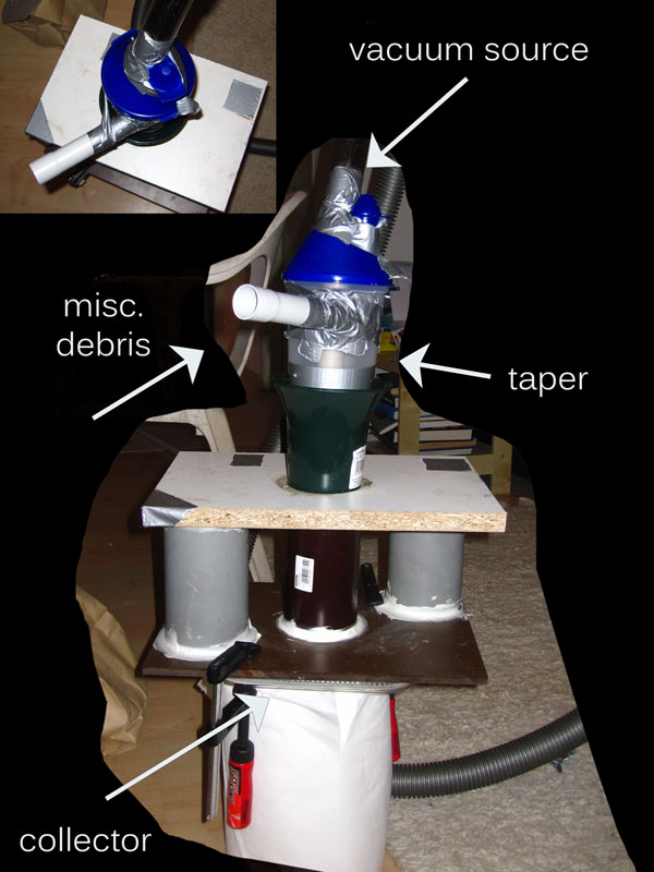

Just because I am so chuffed it actually works.. behold the power of ducttape !!
Proof of concept.. as my ordinary hoover was starting to rust inside (and it it is not even metal to begin with) from breathing too much iron

what is it??

oh it is a cyclonic seperator to keep grit and other crap from ending up in the hoover and cloggin it..
ghetto Dyson. I'm going to use my motor box from my flowbech to suck grit while porting and i needed a way to keep crap out before it goes through my rather expensive vacuum motors
http://aseriesmodifications.wordpress.com/...ome-mcgyvering/

oh good idea

we make them on a more shal we say better scale for seperating sand.
the rectangular shaped block with tangental nozzle seperates sand from water.
http://www.transvac.co.uk/sand_management.php

Nice, really ingenious!
I might be able to source you a reserve vacuum motor, send me a PM.
