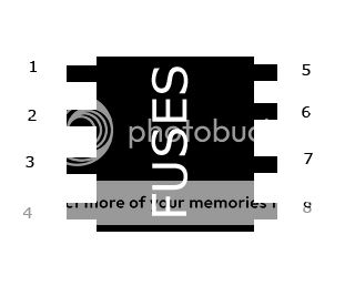

Hello guys,
I have made a diagram of the fuse box below can anyone tell me which are ign lives and which are permanent lives please.

all brown are perm live i thinks

I know top left is live with ignition on and when cranking (if you're looking for a megajolt pin that's the one I used)

im looking for MJ fan EDIS, everything basically I dont want to keep running wires from the engien bay through the car to the boot when theres spare pins on the fusebox I may be able to use :)

Ive always used pin 1 for anything like megajolt, the stud on the solenoid for permenant live, and the engine earth strap for earths.
I think the other bits on that fusebox don't do anything useful.

That might just about do Mike, thanks for your help guys!
If anyone knows which is which then please still let me know :)
Edited by Craigie-B on 21st Aug, 2012.
1 - White, to second ignition click from ignition barrell, coil feed.
2 Brown, permanent from starter.
3, Light green/white from ignition barrell, first ignition click.
4, Red - lighting fuse.
5, Green - all second ignition items.
6, Purple - Permanent feed to things such as interior light, wiper motor etc.
7, Light green/Orange - to first ignition items such as radio feed etc
8, Red/Green - Lighting fuse.
Can you tell ive spent a lot of time studying the mini wiring loom? lol.

If you look closely at the fuse box the terminals are actualy numbered but differently to the order you have them.The Haynes manual diagrams show the number beside each fuse connection.
It goes:
1-2
3-4
5-6
7-8
But for the purpose of knowing what goes where then what youve done will do!

Thanks!!!! I take it the theme with teh wire colours carreis on throughout the car, green being ign live etc?
viz139
108 Posts
Member #: 9182
Yes, except the headlights which change to blue after the switch.
