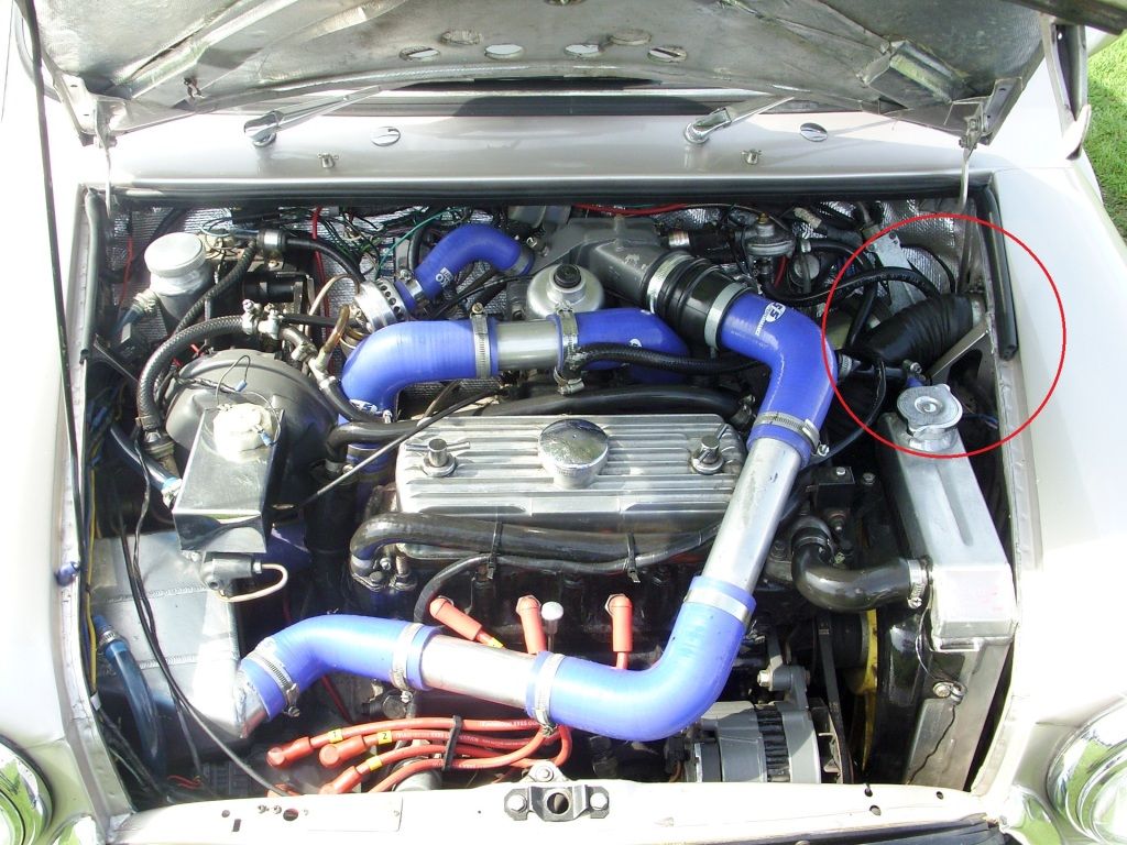

This is what I have done with my mini..
Main Build

From a personal point of view and referring to the right angles on the air intake I'm not looking to drag race it down Santa pod, I was striving for a neat job with a moderate turbo output so a little bit of drag here and there dosent concern me, It is my first attempt at the turbo game and will probably make some changes to the intake in the future, not saying your not right about the drag factor but some times a compromise has to be made for your own personal reasons, every one to there own.. Alan
