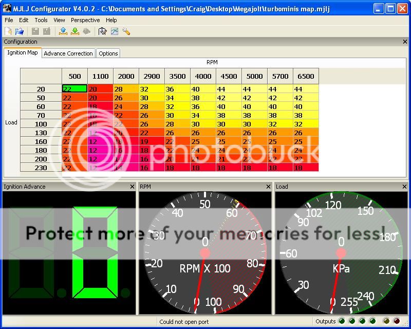

I was told by bennyy to use the map John had for the upside down skip for my car, however my spec is a bit different, this is Johns:
1275 turbo
8:1 CR
gt17
20psi+
phase 2 cam
Mine is:
1310 Turbo
9.1:1 CR
T2
10psi
Kent 266 cam
What I want to know is, is this map going to blow my engine up or will it be alright.

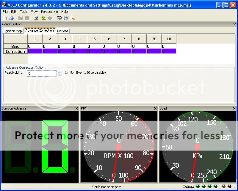

Furthermore I copied the table out from a picture I found, however when going through the software I found a bit saying "advance correction" obviously I havent changed any of this because I didnt know what to put in so its all 0's

The map:

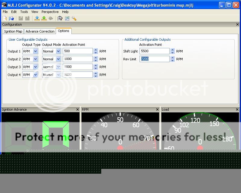

I have set the useroutput and rev limiter myself.
you will have more issues with not visitng a rolling road...
If the fueling is out it will have a great effect on how long your enigne will last.....
IIRC the 266 doesnt have much past 6k
The map references load (boost or vacuum) v's Revs. You'll have both of them. You will just hit the boost at different rev's. It will not blow your engine up.
Edited by apbellamy on 29th Aug, 2012.
