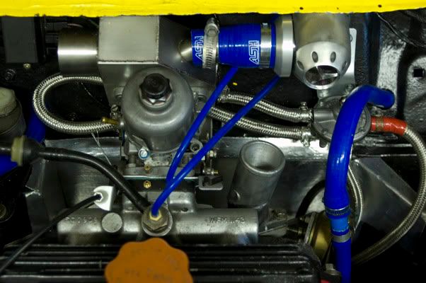

This is the best picture I could find to hand.
Plenum left, fuel reg right.
Fuel reg top-left hose to plenum.
Fuel reg bottom-left hose to carb (loops round the back of the carb)
Fuel reg right hose to fuel pump (red tape)
Fuel reg bottom hose fuel return (peaking out behind the blue hose)

Brilliant thanks Simon.
It looks as if i'm plumbed correctly then.
