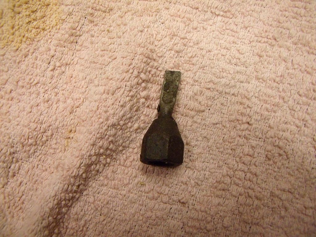

I made two of these to screw on to male fitting, you can weld the pipe end like I did or flatten and bend the end overand flatten again, hope this helps.. Alan

For the female fittings i bought a handful of short 3/8"unf screws and just used those to plug the holes. for the male fittings, I had some rubber caps/ bungs
