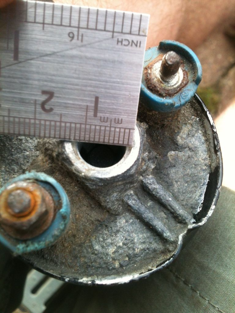

I've been scouring the net for the past couple of days to try and find what thread size my fuel pump has. It's a Bosch item, part number: 0580 254 967. I just can't find the thread size of the outlet anywhere?
Looking on eBay, I think most Bosch pumps have a M12 x 1.5 outlet, but mine looks too small to be M12.
If I can find my vernier calipers I'll get the internal and external thread diameter,

Just found them, the outer diameter is 12.62mm, and the inner is 10.85mm.

Probably is M12 then
