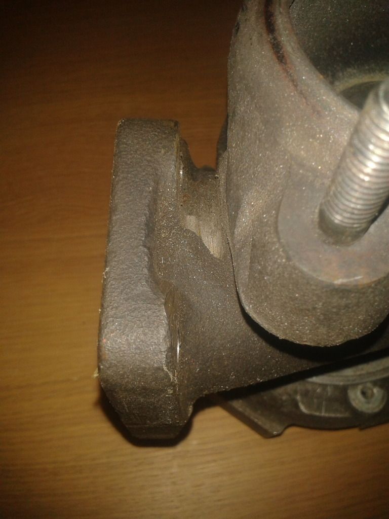

A bugger, this reminds me that I never got a pic for another thread! *blush*
You can do it that way, or you can take a notch out of the turbine housing, so you can get a nut on it. I'll get a picture tomorrow of mine.
I modified the turbine flange as matty suggests to alow a nut to be fitted.
Just too a bit of grinding.
Don't just use 3 fixings, it will blow.

I have done the same and ground out the housing a little to fit a nut in. there is plenty of meat to go at with an angel grinder.

Also, this obvioulsy means that the turbo stud hole threads must be drilled out?
Here's what mine loks like.

Thanks for the picture matty. You drilled out the turbo holes then?
Mattyc33 - I no longer have time to make them especially with the new arrival! I may do some more, when things settle down though.
Billus89 - yep the turbo is drilled out to 8.5mm
