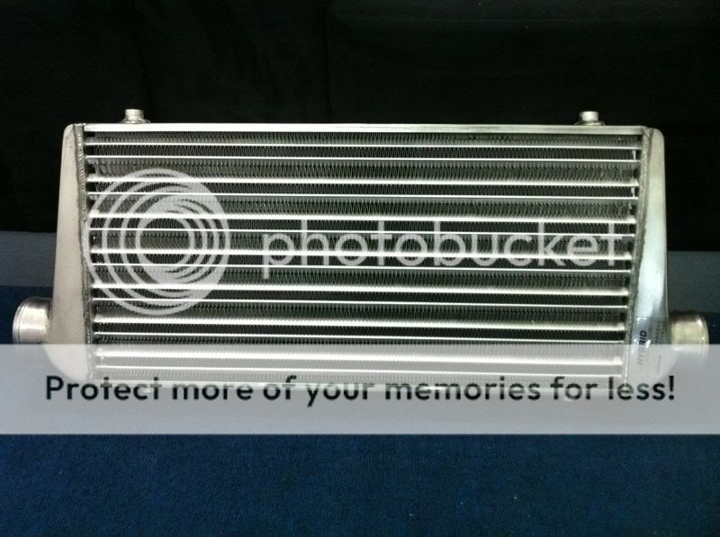

Turbo Dave - heres some pics of it. maybe you or anyone else could tell me if its genuine.
It came in a box which had greddy all over it in the original font. and some chinese on it too... then it was heat sealed in a plastic bag inside the box which had greddy all over it. the fins are painted in silver? which im not sure if they had that as new? and its got a dent (maybe from postage) and the welding doesnt look that great? and the 2 end pieces are cast in ally. theres cast marks on the inside.

stevieturbo
3597 Posts
Member #: 655
Northern Ireland
At £95 you'd be silly to spend any more money. It looks like a good unit.
Although it also looks like the end tanks have been welded onto the core by someone, as opposed to having been supplied by Greddy like that.
