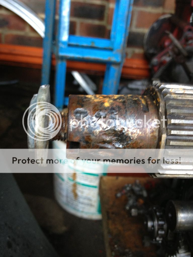

Here's what happened to the taper on a turbo lump I bought that someone decided not to loctite.

As Andy I have never used lock tight on clutch parts, done loads of mini clutches no problem, the problem with the one you bought Mike is was ill fitted on taper and not torqued up tight enough or lock tab not done right..

Lock tabs were up so obv not torqued right, we had to chisel the boss in half to get it off! O.O
