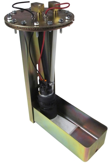

I am not sure this will be of any benefit to any one in the UK as the price is steep and shipping would add to that.

Description:

That is interesting.... Me likey. On 17th Nov, 2014 Tom Fenton said:

Looks quite neat

That's an interesting setup but the high flow is also something I'd think about. Even if the rest of the system can cope with it, there's a good possibility that it will heat up the fuel more than it should.

It looks like the end fitting just shoves inside the end of the 044.

It looks like the US Rally Team site sells both the round version and the square version.

So what range of specifications in a pump would one want for a 1275?

So what range of specifications in a pump would one want for a 1275? I tried to find specs for different Bosch as I know they make many. The only link I could find that worked is from the Aus site: This one is the same diamteer but shorter: 0 580 254 046 207lph (3 Bar) M14 x 1.5 M12 x 1.5 (F) length 169 diameter 60 For ease of use, the bog standard Metro turbo ( AKA Golf GTI, Cavalier SRi etc of similar vintage ) pump is more than adequate in terms of flow, and has a simple push on barbed fitting for the outlet hose. All Bosch pumps Ive come across seem to be the same diameter body. 9.85 @ 145mph

Using an internal pump is ok, but as I said. The biggest issue is sorting a sealed wiring connector to the pump for a swirl tank which will always be full of fuel.

I went ahead and bought one of the 034 versions. They are a local company and were willing to spend time with me even though I was only shopping.

If you have an 044 in there, make sure you have an adequate fuel supply to it. In a low pressure scenario, that's going to be flowing well over 300lph.

I did mention it to them and they felt it should not be a problem, but they may have a limited perspective.

Terry, Have you talked to them about what they would recommend for lowering the pump output flow? I'm pretty sure the pump could be controlled through PWM and your ECU could likely do that using a solid state relay. Jean How fast can the ecu control a PWM output ? and is there any back current protection required on either side ? I'd like to be able to control my pumps via PWM and SSR, but my DTA only has a max output of 1khz. Most of the research Ive done suggest this really isnt fast enough, with up around 20khz being more like what is needed. I think in the case of the 034 setup, just dont use an 044. Just depends what outlet fitting the tank actually uses. But I think there are lower output pumps that have the M12x1.5 output fitting 9.85 @ 145mph

The 034 setup is machined for the 044 form factor longitudinally. I found other Bosch pumps that have a shorter from factor and those would work with the Integrated Engineering square version.

How fast can the ecu control a PWM output ? and is there any back current protection required on either side ? I'd like to be able to control my pumps via PWM and SSR, but my DTA only has a max output of 1khz. Most of the research Ive done suggest this really isnt fast enough, with up around 20khz being more like what is needed. I think in the case of the 034 setup, just dont use an 044. Just depends what outlet fitting the tank actually uses. But I think there are lower output pumps that have the M12x1.5 output fitting The ECU Terry is using has PWM outputs that can go more than 20kHz. The maximum is about 90kHz with a resolution of about 0.4% duty cycle. Jean |
