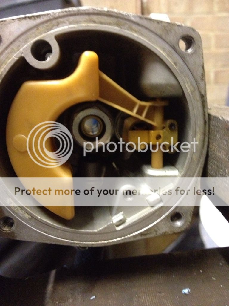

So I checked tom fentons guide and the one on turbo-mini and it mentioned nothing about what I seem to have :/
The carb had a pin in, so I took it out and I assumed the float chamber pin would fall out and it hasnt moved. It appears to have some form of blue solid in there.
Piccies below:
Da Fuq!?

get the blue stuff out.

so it is an actual allen bolt head then?

if remember it ok, yes.
Its is a bolt which you screw out.

that looks more like this to me but it shouldnt be to tight you could maybe get some pliers on it at a push

I cut a slot in it using a small cutting disc in the dremel, you can then use a flathead driver to screw it out.

Is it actually an arse to get out or is it easy enough?
4642 Posts
If you do what I said, it comes out pretty easily.

okay cool, thanks :) will see if my dad has a dremel :)

i did same as phil, worked a treat!
Just use a tiny screwdriver and scrape the crap away from the "edges" of the hexagonal shape so that you can get the allen key in there . It comes out easily.
Or do what i did and just put a flat head screw driver in there and got it out easy as pie
