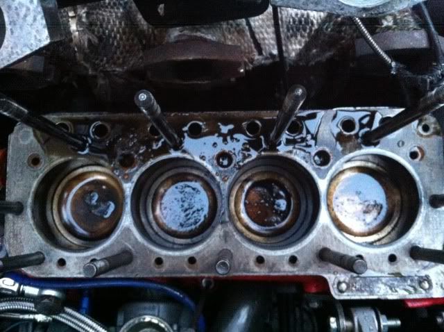

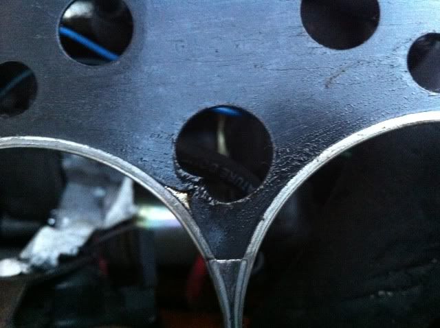

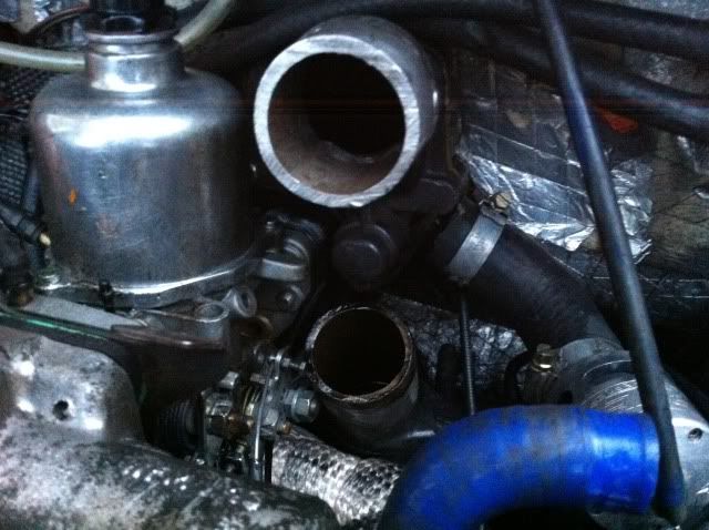

Right took it apart there is oil from the turbo into the inter cooler nothing going the carb and no oil out of the turbo to the exhaust.. I have the head off and there is oil in the pistions and the head gasket looks a little gone but from a water way to the pistion... Hope this helps

a few pics
befor
Turbo needs a rebuild looking at the snail outlet. the oil in the bores and on the deck is likely to have come of the head when you lifted it of..
The burn in the gasket wouldn't cause the smoke problems.

If I do need one where can I buy a reckoned one from as Avon bar is not there no more? I brought this one from them 1 year ago... The other thing I am confussed about is there is only oil going in to the inter cooler not coming out the other side to the carb?

That head gasket looks like the head is under torqued. Check your torque wrench.
