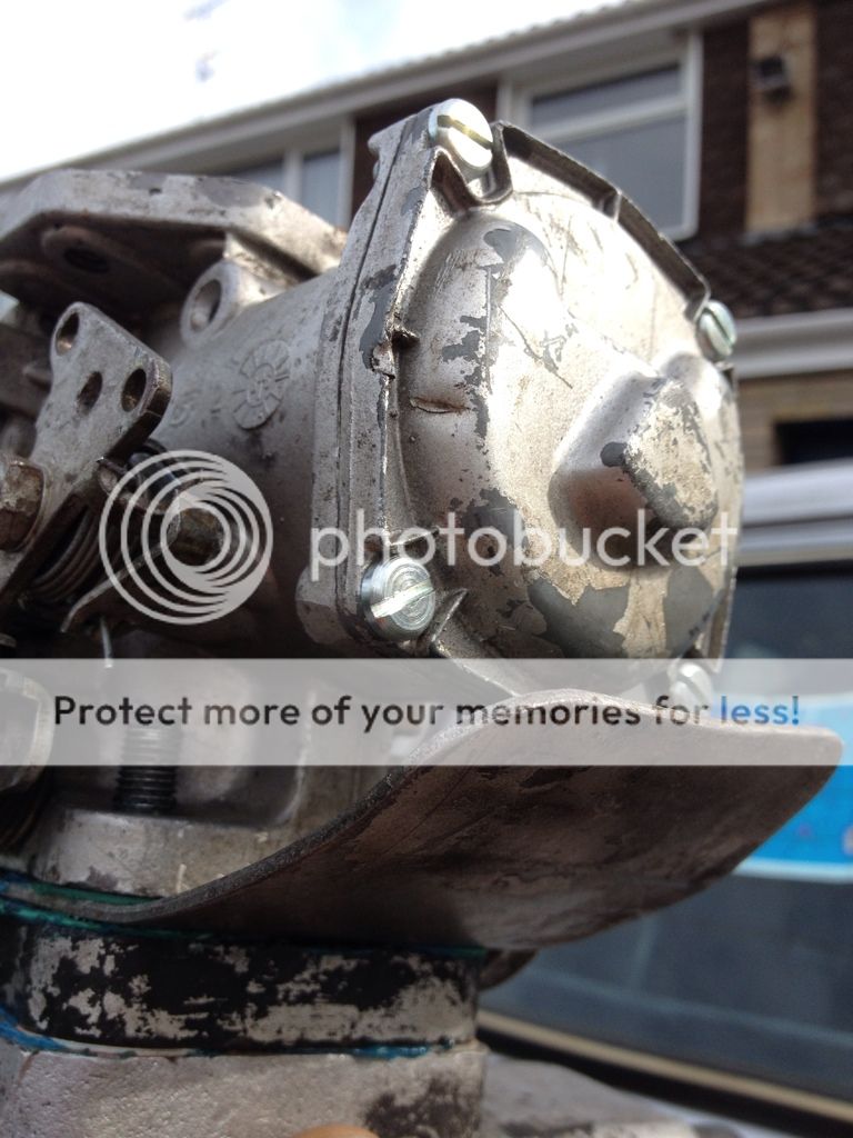

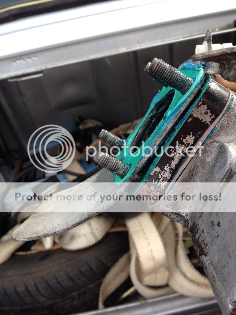

I wasn't aware of this issue, however my engine came with the throttle linkage plate (that goes between the carb and the spacer) bent to go under the carb like this:
Car had no trouble what so ever getting started after it was on the rolling road giving it the beans. Maybe worth a try? That said I havent had mine on the road properly yet so may not be as effective as I am hoping.

The Metro turbo and I presume ERA turbo had a proper heat shield underneath the carburettor. Nothing like that silly piece of bent metal in the picture above which would do nothing.
